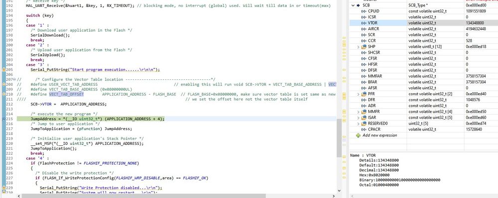

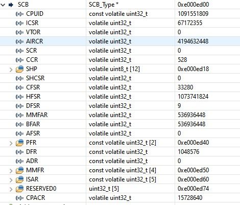

inside the hardfault_handler I read the SCB and get the following
which gives a BFSR register error at address 0x20010000 which points to a reserved space

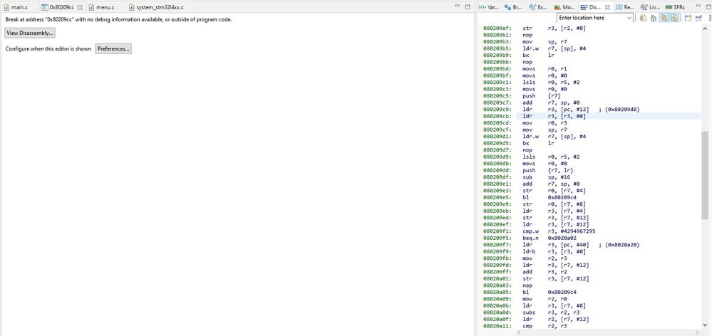

2021-05-16 8:54 AM
I added __disable_irq(); before jump. Disassembly just before it crashes
About the link file. I don't see why I need to change it. I'm transferring a binary file.
Is the flash area to be written included in .bin file ? I need to have same file run in area A or B.
I understand the offset I need to change which is done by the line below , but still won't work ( I tried with my defines in my previous messages)
#define VECT_TAB_OFFSET APPLICATION_ADDRESS - FLASH_BASE // (=0x0002 0000)

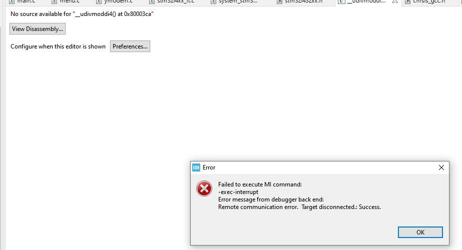

Ok I think it's clear now that I can't use the same .bin file. I will have to ask the running app which area it uses to send the correct file.
I changed the link file like this
MEMORY
RAM (xrw) : ORIGIN = 0x20000000, LENGTH = 64K
FLASH (rx) : ORIGIN = 0x8020000, LENGTH = 256K
and set my defines before jumping
#define USER_VECT_TAB_ADDRESS
#define VECT_TAB_BASE_ADDRESS (0x08000000UL)
#define VECT_TAB_OFFSET APPLICATION_ADDRESS - FLASH_BASE (= 0x0002 0000)
program seems to jump at the right place but stops running at this point
