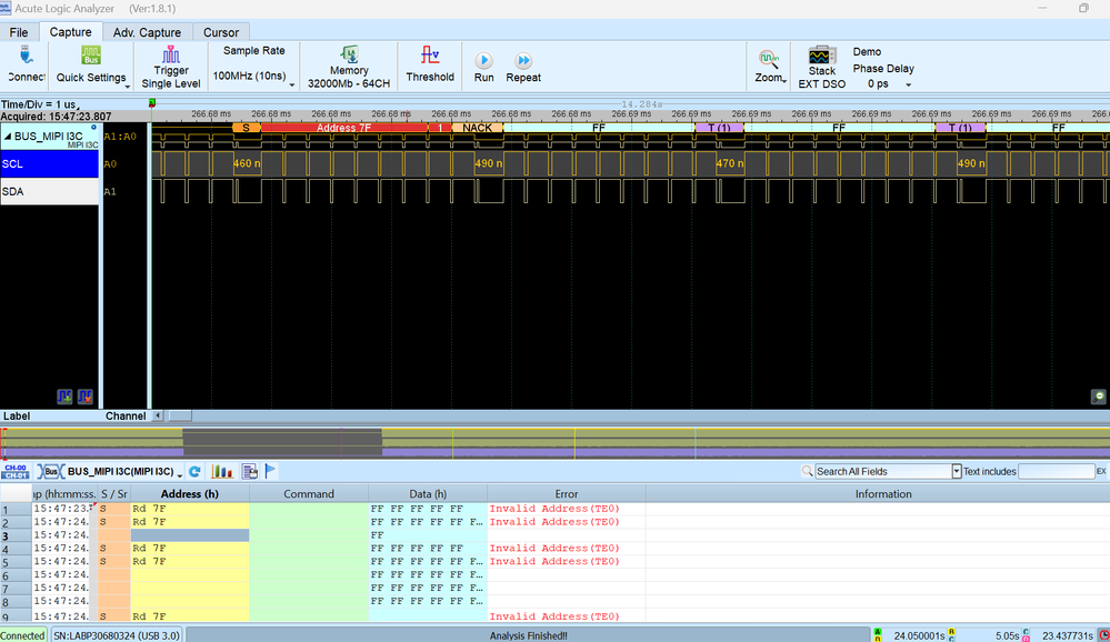

I am using 2 Nucleo-H563ZI boards, one as controller and the other target, and referencing the knowledge base post "How to set up and run the I3C_Private_Command_IT controller and target example projects" yet I am getting an error. From what I can tell, both projects can be used on the same laptop unit, and only one of the projects needs to be running at a time, but please correct me if this is wrong. I also have a Logic Analyzer hooked up to the set up and am receiving this analysis, pictured below.
According to the post I'm following, when the user button is pressed on the controller board for the first time, the LED1 on the controller should continue to toggle quickly and the LED1 on the target should turn solid green, but this never happens. Instead, the target LED never turns on, and the controller LED toggles slowly. According to the project read me, this means there is an error in the transmission/reception process. What is the best way to determine what is the error is exactly?
Also, according to the analyzer, the controller is sending out a 7F instead of the expected 7E broadcast. The example projects were not altered when imported- so just running ENTDAA- but there's clearly something not right with the setup or use. How do I determine what is causing the error? Do you think it's the 7F? If so, why would it be sending this out instead of 7E?

@Foued_KH  Thank you for the response but I am going to need more information please. I see 0x40005C60 in register I3C_DEVR0 on both the Target and the Controller and bits 1-7 is the dynamic address which is 0x30. First I have both STM32H563ZI boards plug in and both have their LEDs green. So both are active running their own board firmware. When I start the controller code only, the code runs to the Handle_ENTDAA_Controller() routine and the analyzer shows no activity. When Handle_ENTDAA_Controller() code runs the analyzer shows that the controller is try to send something  but the Target did not turn any green LED on, which means it never recieved anything. This is just not working for me.

2) I reloaded I3C_Target_Private_Command_IT and I3C_Controller_Private_Command_IT from EXAMPLES_LL, made no changes to them and I still cannot get them to work following the example instructions given above. I currently believe there is some setting in the compile that I am not setting correctly, because the analyzer always shows start or start_repeat followed by 0x7F never a 0x7E. It as if the wrong code is being generated. I see the green led blinking 3 times a second, then after we press the blue button, it blinks slowly, meaning an error, which of course is correct if 0x7F instead of 0x7E is being transmitted. What settings should we be using for the compile and debug? The MX settings on the wiki differ from the example .IOC settings. Is this a factor? The wiki lists different clock and pin settings than the example defaults, but they are using a different board, so I just want clarification.
