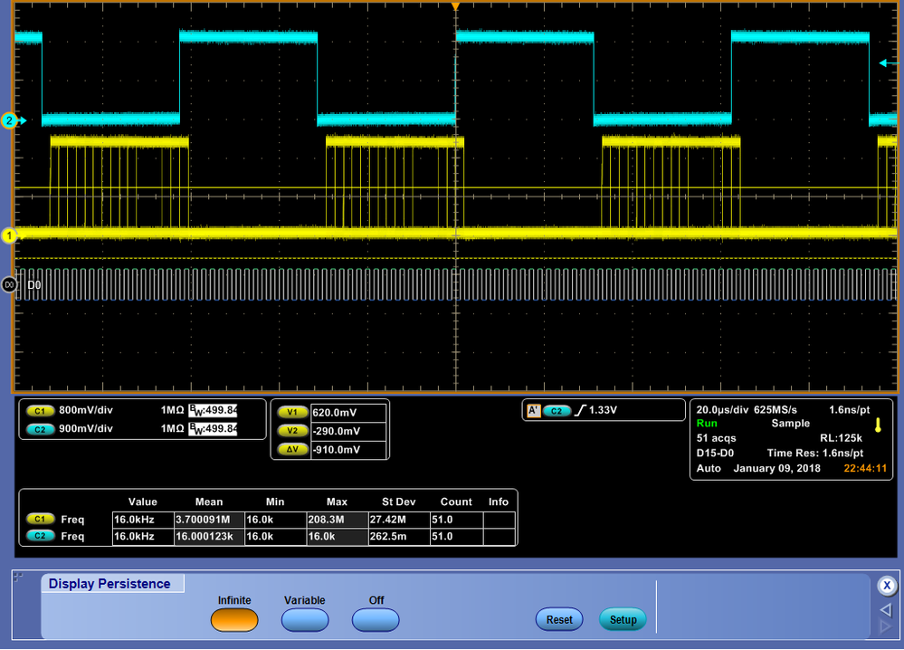

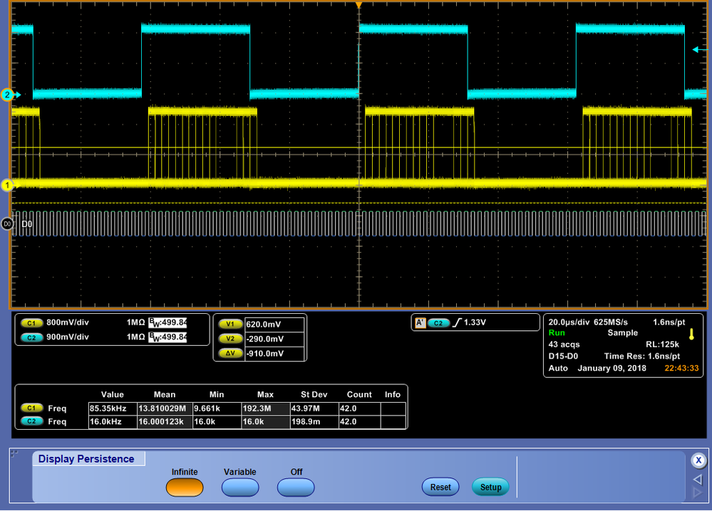

and others:I was able to remove the codec off a board sucessfully. This confirmed my suspicion that the problem is in the ST microcontroller, not the codec.
See two screen captures below. I'm playing the exact same tone in both cases with left audio only.
In this case, data output when WS=1
In this case, data output when WS=0
The data in my output buffers never changes. I always observe that the even indices of the buffer have non-zero values and the odd bits are zero.
I also found out something very interesting...the RX data has the same swapping issue!
I'm still stumped, but happy to be ruling some things out. If you have any input or suggestions to try, please let me know.
