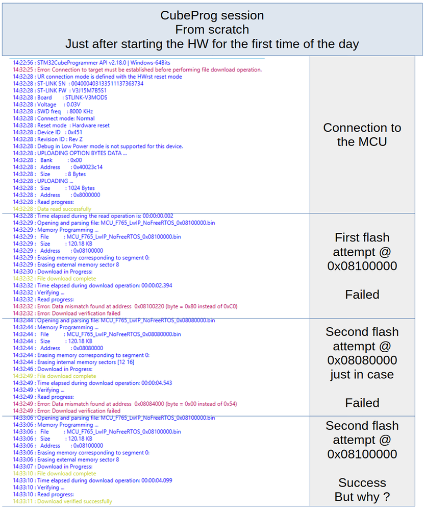

Context : I’m using an STM32F769I-DISCO on one side, and a custom board based on a STM32F765VGT6 (dev ID 0x451 ; rev ID : Rev Z). I used the discovery to get familiar with the concepts, but now, I’m using only the custom board.
In the following explanations, BHuCP means “BY HAND, using STM32CubeProgrammer” (CubeProg in short).
So far, the best result I got is :
Before continuing, please confirm : I must set a proper line
FLASH (rx) : ORIGIN = 0x8000000, LENGTH = 1024K
in the linker script ? This one is the default.
I need to set the length at 512K (half the 1 MB of the F765). And I would need one line/one setting/one linker script for boot address (ORIGIN) of bank 1, and another for boot address (ORIGIN) of bank 2, correct ? Or can a FW build with ORIGIN = 0x8000000 boot from the bank 2 ?
Now, why am I complaining ?
Because of the following :
So, what am I missing ? Obviously, an OTA cannot require the client to install STM32CubeProgrammer to alter Option Bytes or flash the new FW. How do I alter the boot address of the MCU ?

After struggling again with CubeProg to flash the bank 2 FW, I'm able to :
At last, some progress.
I'll make some more tests, and a pause, to wait for your answers, before coding the download of a new FW into the inactive flash bank.
[DAY 2 - 1/2 : the struggles with CubeProg]
Apart from the confirmation/invalidation of the bank 2 start address I'm using, here is today's first flash session :
