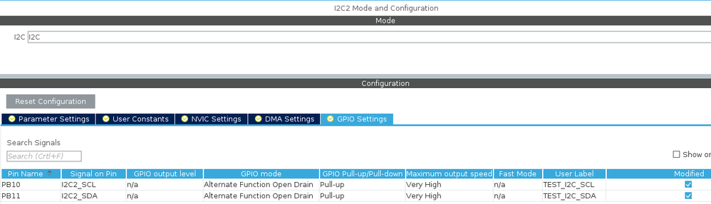

I2C2_SCL on PB10 (pin L4)
I2C2_SDA on PB11 (pin M4)
Both have a pull-up resistor of 18K.

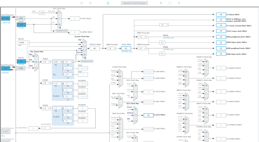

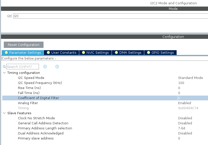

I have generated code through STMcubeMX (version 5.4.0).
Using the internal clock as a source:
