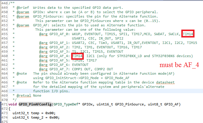

Thanks @Community member !
It was my mistake. PWM operates well.
I selected the wrong AF channel.

GPIOA->AFR[0] = 00000000
Look into datasheet, Alternate functions ... table - for PA4, TIM4_CH1 is AF4. That means, that GPIOA->AFR[0] must have the 4th nibble set to 4, i.e.
GPIOA->AFR[0] = 0x00040000
I don't know how is this set in SPL.

Oh, I see.
Unfortunately, the assignment of peripherals to AF in the GPIO matrix is not fixed (it is to some extent in 'F2/'F4/'F7, but it's not in other families, and it tends to get worse with increasing number of pins). So, at the end of the day, you need to check each pin individually in RM, or rely on tools like CubeMX, if you can bear their result.
