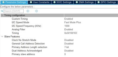

Please tell me about I2C timing configration.
I use Nucleo-L552ZE-Q.
I set up the I2C as shown in the picture following the reference manual(RM0438, Table 326).
The fi2cclk is 48MHz.
But SCL cycle is very slow.
How can I set the SCL cycle to 1000 kHz ?
Best regards.

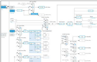

Please review your clock configuration to ascertain that the peripheral clock is correct. If the crystal is not oscillating, it may swich back to internal.
2024-12-15 5:06 PM
Thank you for your reply.
I checked my clock configration.
I don't use external clock.
Please let me know if there is something that needs to be changed.
