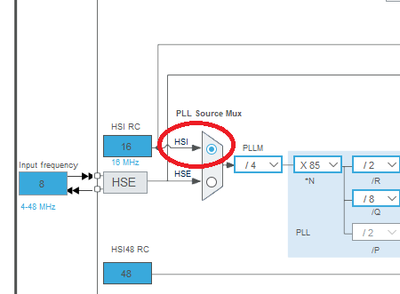

For CAN/FDCAN subject especially when using Normal mode you need to provide more details especially the HW part. So please share schematics.
Also, I recommend to use HSE with an external crystal instead of HSI.
As per your code:
RCC_OscInitStruct.PLL.PLLSource = RCC_PLLSOURCE_HSI;

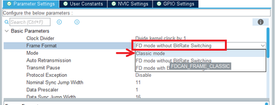

Could you please share your ioc file?
Chenge FrameFormat to FDCAN_FRAME_CLASSIC;

Ok,
But contrary to what I suggested earlier, here you are still using HSI:
And CAN mode :
-> Try to switch to Classic mode.

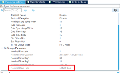

And also, are you sure the two nodes have the same config especially the bitrate?
