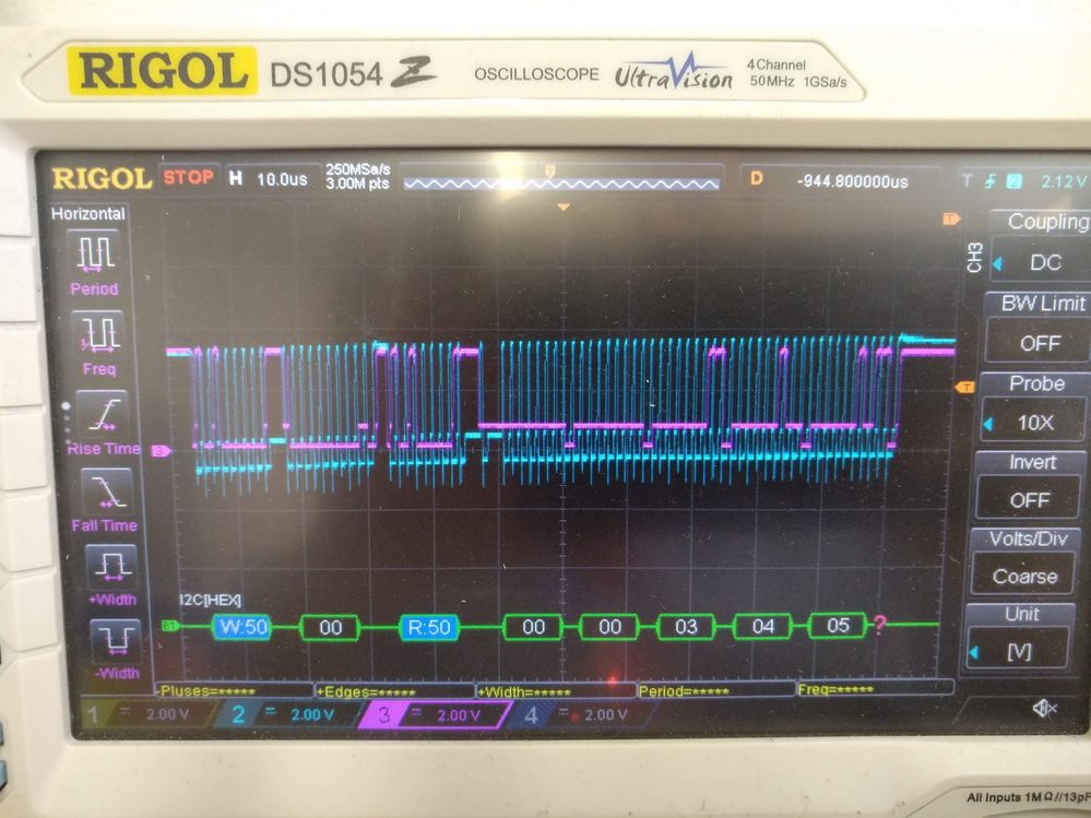

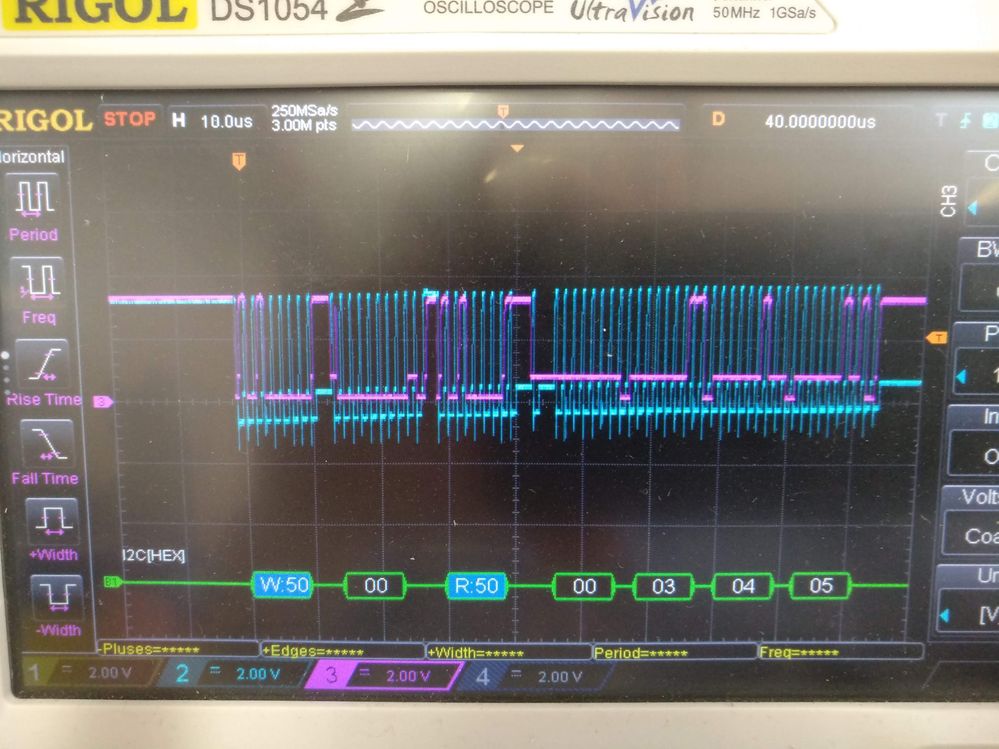

Here some captures from the oscilloscope:
Both rx/tx cycles. Clock line is kept low after 2nd tx because of the missing last byte I guess.
Data of first rx/tx. Notice the incorrect two bytes.
Data of second rx/tx.

That plot doesn't look right. You have a low level, a high level, and a mid level. Almost like two things are trying to drive the bus at the same time. Maybe something is configured in push-pull instead of open-drain. What else is connected to SDA/SCL?

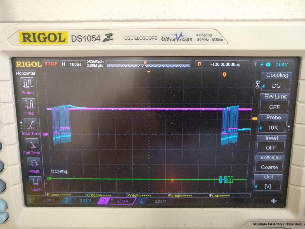

while(HAL_I2C_Slave_Transmit(&hi2c1, i2c_tx_buf, I2C_TX_SIZE, 200) != HAL_OK);Now is sometimes works for some seconds before hanging with the same problem (clock line on mid/low level).
2020-08-10 1:07 AM
The problem seems to be with the F301-Slave-Board. As soon as I press the reset button the clock line goes high again and the master starts trying to write.
