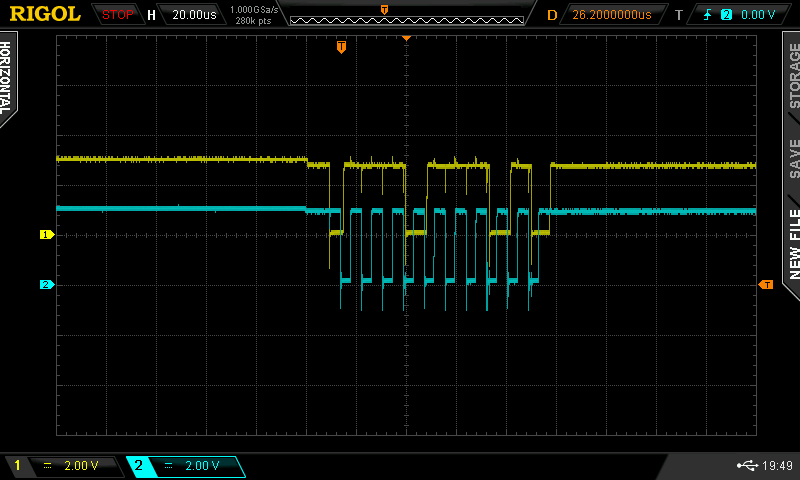

But the O-scope shows me different a picture:http://s1photobucket.com/user/esovo/media/Newfile1_zps0461710c.jpeg.html

I have try it both, but it isn't working. Here is the proof:2015-01-07 5:02 AM

I am a bit concerned with the level shift observed at high level at the moment the I2C starts. Are you sure that you correctly configured GPIO as open drain in the PIO controller of the STM32 ?

Could it be that my timing is off and thats way I get the high bit at 9th SCK place?
Is this a STOP bit?
