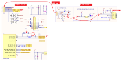

In this case, Is the position of pull up resistor matter?
What will be the best position for the pull up resistors when the Mater and slaves are in different two boards and they are connecting with wire harness?
Please find the schematic in one page here,
I would leave the overall connection as it is, but instead of R47, R48  0R I would put resistors of approx. 20-40ohm. These should prevent extreme current spikes while maintaining proper I2C line function.
