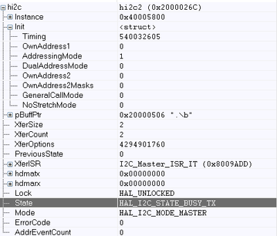

it seams that HAL_Status is not READY when calling it from the UART so it has a loop at
while (HAL_I2C_GetState(hi2c) != HAL_I2C_STATE_READY){
when we call the function from the Application.C file, there is no issue
print of the Watch list at the While statment:

Are you calling it from an interrupt / callback ?
If you're calling it from foreground and background you're going to encounter situations where you're mid usage.
Other than that look at how the functions / structures are shared between different files.
2024-06-30 7:22 AM
Since you have not attached the full project, we can only guess on the probable issue. You seems to access the I2c bus from timer as well as from the uart handler. you can put one volatile variable such as I2c busy or something to avoid simultaneous access to the bus. or alternately since you have the status already, you can take it from previous read, set the port expander IO in the next 100ms cycle from a structure or variable. there will be max delay of 100ms only.
