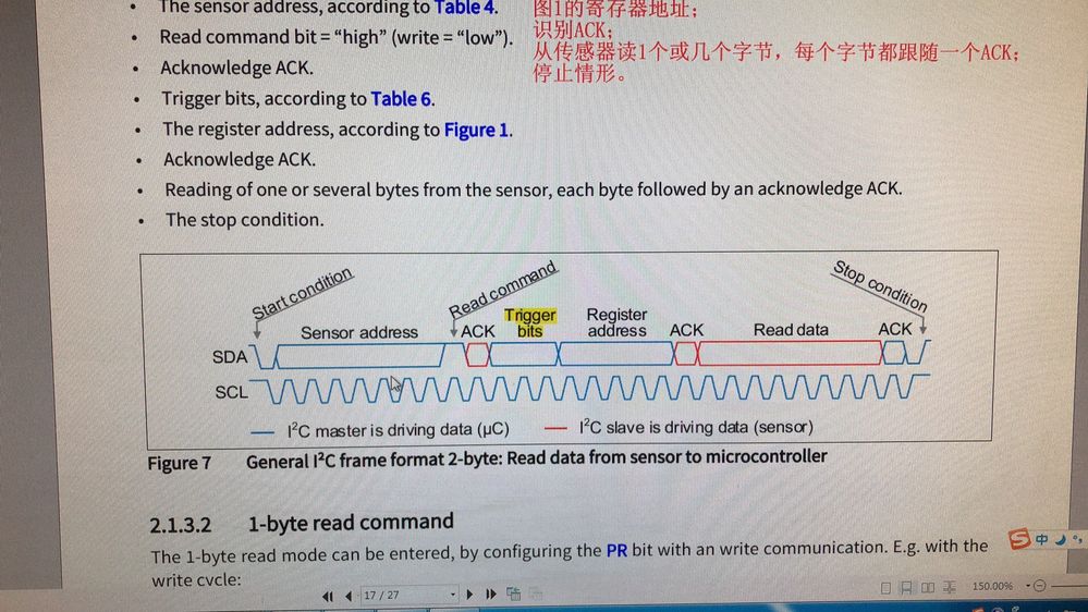

I'm using HAL_I2c_Mem_Read(), too.
And may I ask if STM32's I2C can generate wave like the following picture. I have tryed Mem_read() and any other function in i2c.c , but the bit following device addres is "0",which means "write" in I2c.
May you help me out, thanks.

Yes, that doesn't look like the usual I2C method, which is to have a WRITE with the Register Address, and then a READ which pulls the data.
Probably going to need to bit-bang the frame here.

thanks for your reply,
I have bit-bang and success, but I just want to know may stm32's i2c hsrdware generate the ware, by the way the chip is infineon's tle493d-A2B6.
have a nice day.

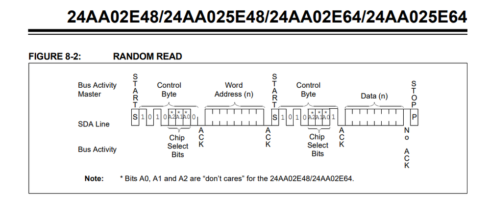

2023-06-06 10:58 PM - edited 2023-11-20 9:40 AM
24AA02E48/25E48/24AA02E64/25E64 Data Sheet (microchip.com)
Notice the Restart bit in the middle? That is true I2C.
It does not match your reference shared document.
Same device, really?
