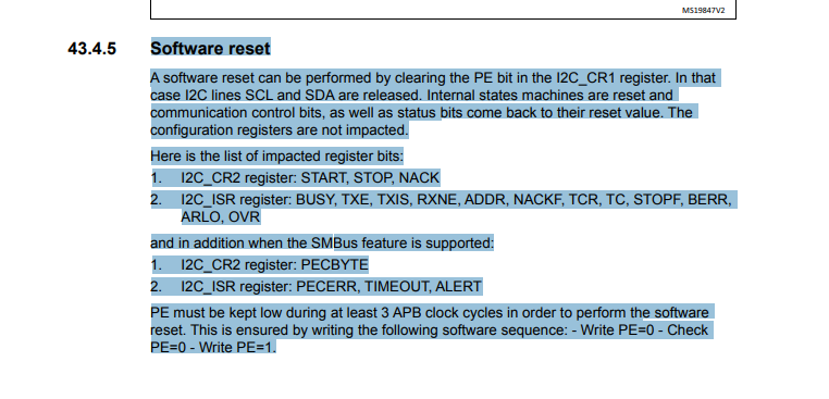

The STM32L4 Series and STM32L4+ Series devices implement a different I2C peripheral
please tell me how i need to proceed for I2C Start, on which control registers i need to take which has both START and RESET
-Nesrine-

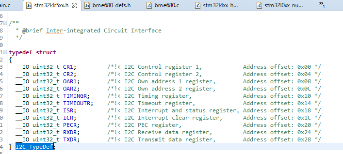

Board: Nucleo144- STM32L4R5ZI.
I want to write I2C_start condition .
Use case: Read/write sensor BME680 over I2C.
Please tell me what are the equivalent for
I2C_GenerateSTART as in case of STM32FXX series.

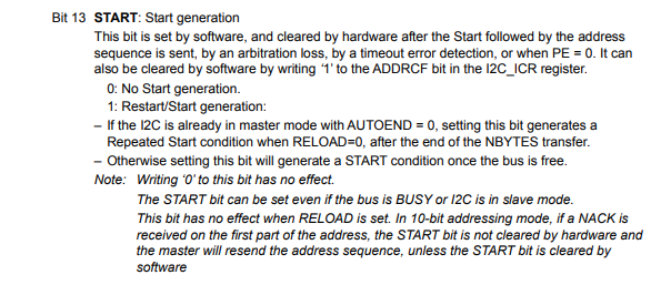

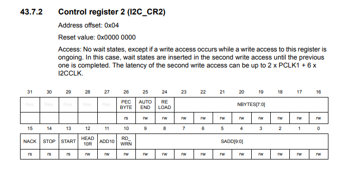

In Case CR1 series i cannot find
I2C_CR1_START and for RESET i find I2C_CR1_SWRST Case CR1: START :: NO RESET :: YES
But i cant find for CR2 for STM32L4XX series. The above explain is for Start condition of I2C as like this : Case CR2:: START :: YES RESET :: NO
D_LOG(''Generate start condition\n''); dev->CR2 |= I2C_CR2_START; // This will make start of I2C on CR2. For CR2 its not available. i want to know why there is not there for CR2(control register 2).

Thanks for the support Nesrine.
Yes for SWRESET
On I2C_CR1 bit 13
