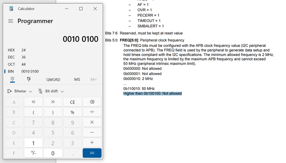

Bits 5:0 FREQ[5:0]: Peripheral clock frequency
the description of the frequency divider is extremely unclear. there is no formula for where the input is, how it is divided, where the output is. what if I want to set strictly 50kHz for iic ?
once again, to understand the documentation, you need to switch to the "fortune teller" mode.
and then there is a separate I2C Clock control register (I2C_CCR).
the concept of fPCLK1 is used there, but where did it come from?
"let's guess."
"the maximum frequency is limited by the maximum APB frequency and cannot exceed
50 MHz"
but the description of APB1 says a maximum of 36 MHz.
how did 36 turn into 50 ?
the name of the PE bit gives a special thrill;
parity error ?
no, it's the peripherals to turn on.
in all documentation, all allow bits start with EN;
which is kind of logical, to allow a bit of such and such. but suddenly, in one place, the logic of the document is forgotten and we get PE instead of the logical EN_Peripheral;

Hello @placidity.master_gmail.com,
The maximum APB frequency :50 MHz.
The maximum peripheral clock frequency : 36 MHz
This condition is respected :
==> Higher than 36 MHz not allowed.
Foued.
2022-12-16 6:53 AM
and the line above says about 50 MHz, almost in one place two contradictory installations.
2022-12-19 1:16 AM
The frequency is limited by 50MHz ( max APB frequency) but cannot exceed the 36MHz.
