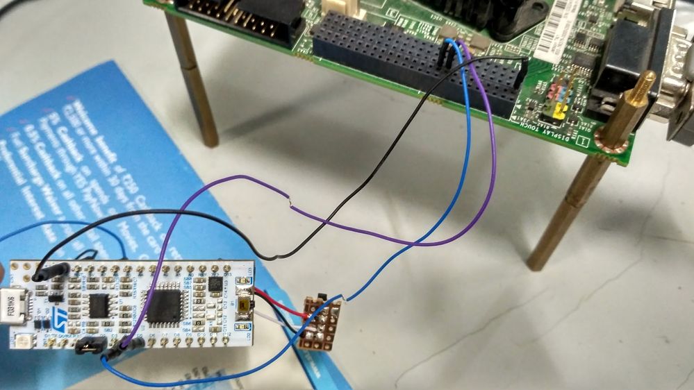

I have a STM32L071KB Chip Inserted in a STM32F031K6-Nucleo Development Board.
I am trying to Get into I2C Bootloader mode by Setting BOOT0 Pin to HIGH.

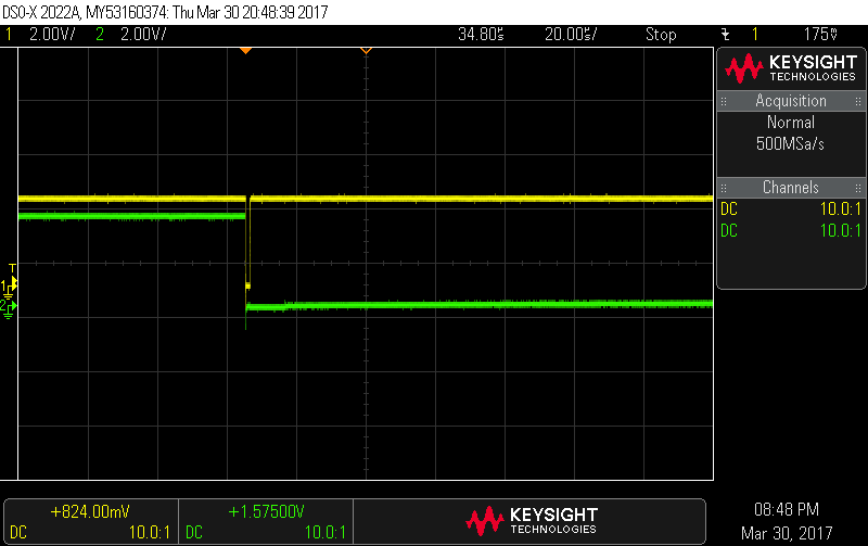

But When I Try to detect the I2C Slave Address (0x42), SCL pin is driven low, and timeout error occurs.
TIA.

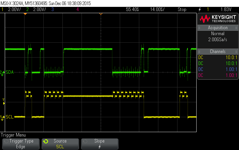

Have similar problem with STM32L432KC-Nucleo board. I2C1 is working if used in example firmware (or my own firmware) but not with bootloader.
Something strange is happening with SCL (see screenshot)
