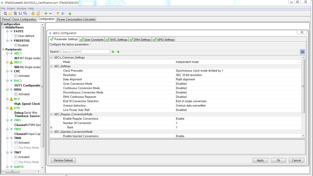

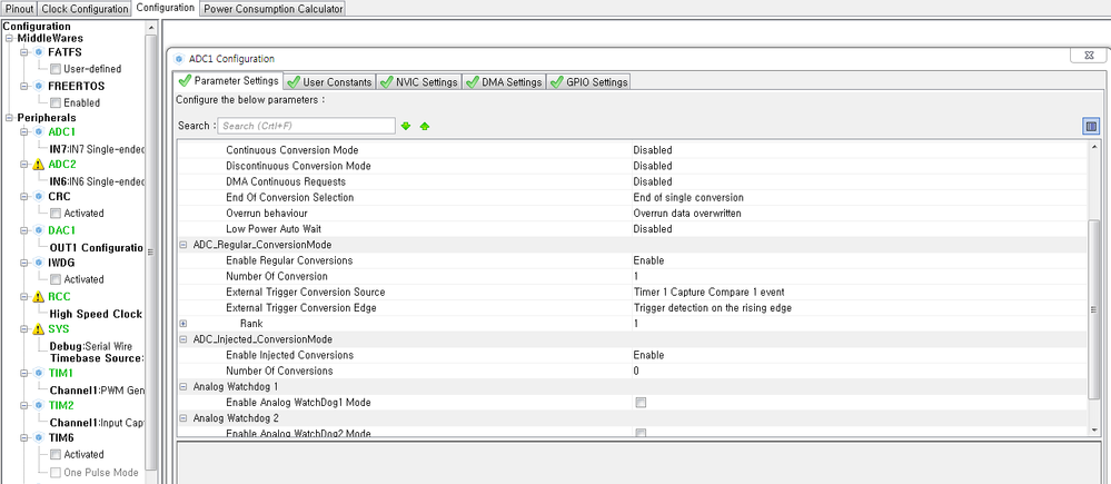

I have used stm32f303vdt with cubemx
but i updated cubemx ver.4.19
i want to use ADC with trigger mode
ADC1 have trigger mode but ADC2 don/'t have triggermode
how can i solve it?(before i used ADC1,2 trigger mode but While updating it disappeared.

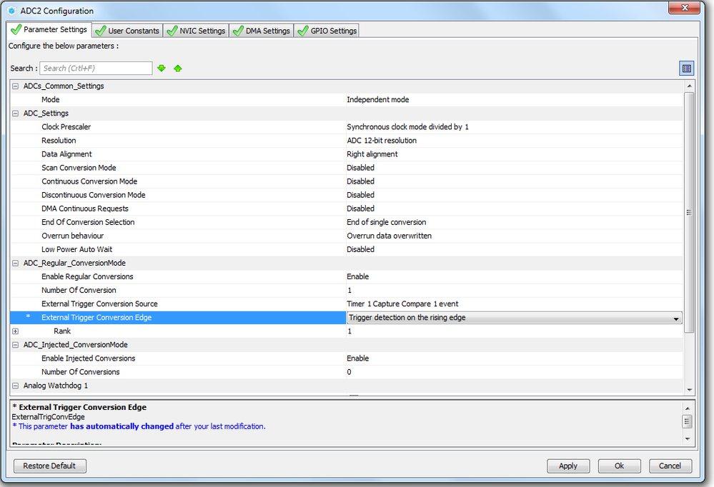

I have checked from my side using CubeMx version 4.20 and I have trigger mode for ADC2.
Please update CubeMx version and try with the last version 4.20, then keep me informed about your updates on this.

I updated CubeMx. i resolve it. Thankyou.
