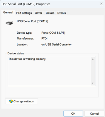

2025-01-27 4:59 AM
as you can see in device manager under ports section it shows the (com12)
2025-01-27 5:03 AM - edited 2025-01-27 5:45 AM
So again check your FTDI status. For example you can loop back Tx to Rx and send characters with a HyperTerminal. If you receive what you sent this means your FTDI module is OK.
Again check all your connections (continuity test) and what USART1 pins you are using according to the application note I shared before: Tx: PA9 / Rx: PA10. Check if you did your Rx/Tx pins connection to the correct Arduino connector pins. You can do a mistake while wiring your circuit
2025-01-27 5:30 AM
I have just completed the loop back test, and it is working fine any other thing that I'm missing right now?
