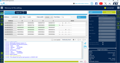

USART1_stmconnection
USART1_FTDIconnection
power supply
After much trial and error, I successfully connected to the UART bootloader on the STM32. Below are the steps I followed:
Answer: Initially, I was powering the FTDI module using the STM32 by connecting the VCC of the FTDI to the VCC of the STM32. While this can work if your power output is adequate, to avoid the issues I faced, I recommend powering the FTDI module directly from the host. Ensure you have a common ground between the STM32 and the FTDI module.

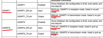

Need to refer first to the AN2606 / Section 31 STM32F401xD(E) devices:
These are the USARTs and theirs respective pins that you can use with the bootloader for this product:
And you cannot use other pins.
Hope that helps.

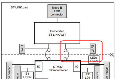

The ST-Link has two connections to the Target microcontroller:
So using the ST-Link for programming (downloading) does not preclude using the UART for comms.
PS:
Or, if you want to disconnect that UART from the ST-Link, you can do that and still retain the SWD programming connection.

Which USART1 Tx/Rx pins you have used? PA9 and PA10?
Also check your connections and check your FTDI module (Are you sure your FTDI is normally working either on Tx or on Rx?).

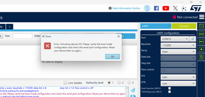

I am encountering the above error, and for clarity, my goal is to flash the firmware using the UART bootloader.
2025-01-27 4:50 AM
Are you sure the FTDI is on COM12?
