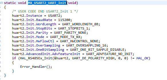

Here is my UART setup:

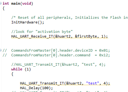

here is my test main:
After every "Test" transmit my Rx interrupt triggers with a null byte.
Does this maybe have anything to do with the DE control or timing? I am out of ideas.
