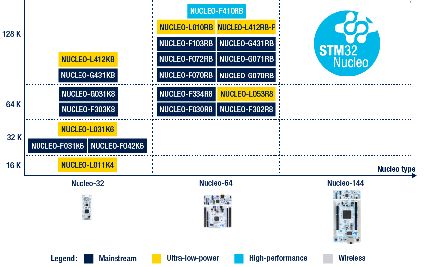

I would like to buy a microcontroller package and I am seeing the difference between the Nucleo-64 microcontrollers since they all have almost the same specifications but then I saw that there are 3 notable differences which are "Ultra-Low-Power", "Mainstream" and " Performance "so I can't decide between a low power or mainstream microcontroller

They are all quite similar. Some are faster, some are cheaper, some are better at low power. The differences are subtle.
If you have no particular need in mind, perhaps use availability or popularity as a factor. STM32F4 has a ton of reference material online.
2021-08-10 9:49 AM
The 16KB code space of the L011 parts are a bit challenging/tight
I would generally lean toward the NUCLEO-144 boards as there are more pins, less compromises.
Of those the F4 models perhaps have the longer lineage and code examples.

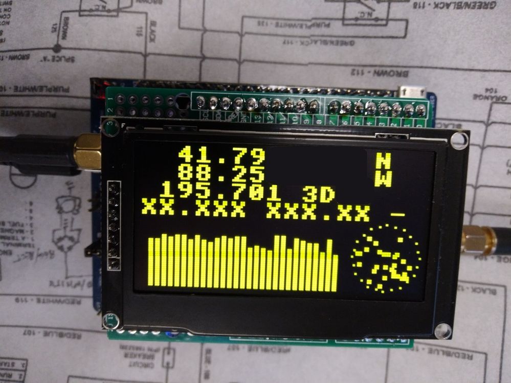

Screens/Displays, that can get very subjective, I personally quite like I2C interfaced OLED displays using the SSD1306/1309. You can paint/draw your own framebuffer, doesn't take overwhelming resources on pins, memory, etc
