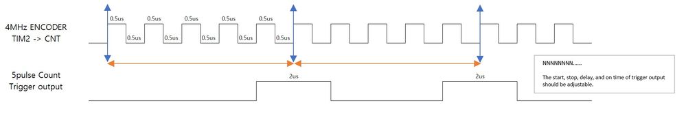

2022-09-28 11:35 PM
I don't quite understand, what are you trying to accomplish. Try perhaps to draw a timing diagram.
2022-09-29 1:19 AM
This is a block diagram that requires trigger control.
thank you
2022-09-29 2:21 AM
OK so if I understand it correctly, you need to count pulses within a period, and if there were more pulses than a threshold (i.e. higher input frequency), you need to output a pulse.
The "if there were more pulses" unfortunately implies some processing which has to be done by the processor, so I don't quite see a way how to do it purely in hardware, without interrupts. Sorry.
