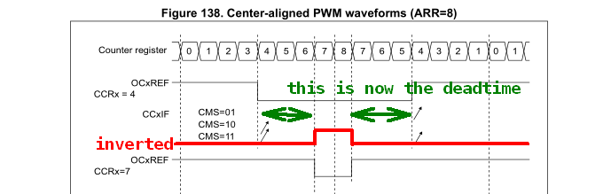

I already know timer3 has not like timer 1 and 8 dead time generation featur. but maybe there is a way to add it!
2020-04-11 11:18 PM
The closest thing might be PWM center-aligned mode on two channels, either with inverted polarity on one channel, or PWM mode 1 on one channel and PWM mode 2 on the other.
2020-04-12 3:36 AM
Thank you very much. i will search what you say things. İf you know it, can you detail it for my understand?
