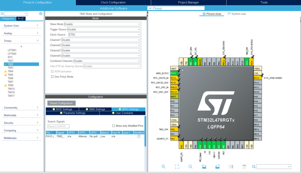

Thanks for the help. I am trying to use the 32 bit timer 2 for my application. In the ioc application, this is the settings that I am using. Does this look alright? Also, what is the proper way to read the counter of the timer when I am in the main function?

Looks fine to me. Make sure your period is set to max, if that's what you want.
Proper way to read the timer counter is to read the TIMx->CNT register. TIM2->CNT in this instance. You can read this directly or use the __HAL_TIM_GET_COUNTER macro.

I got the timer working the way that I wanted. Thanks for the help!!!
