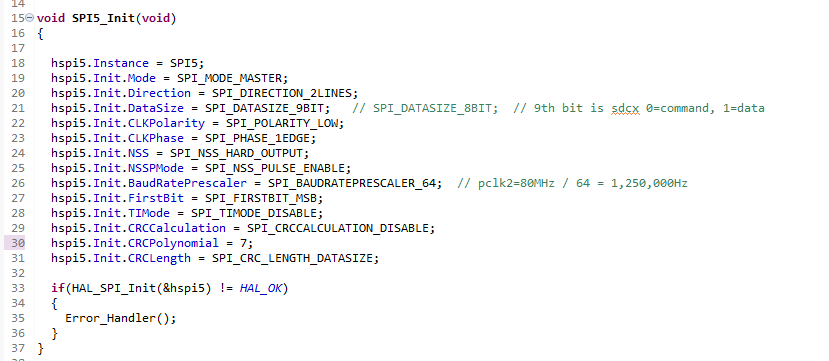

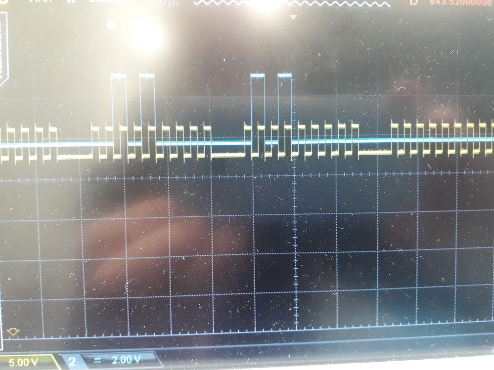

The HAL_SPI_Receive data and clock waveforms are shown below:
SPI initialisation:

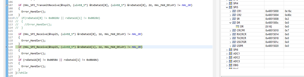

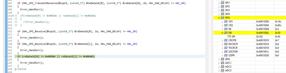

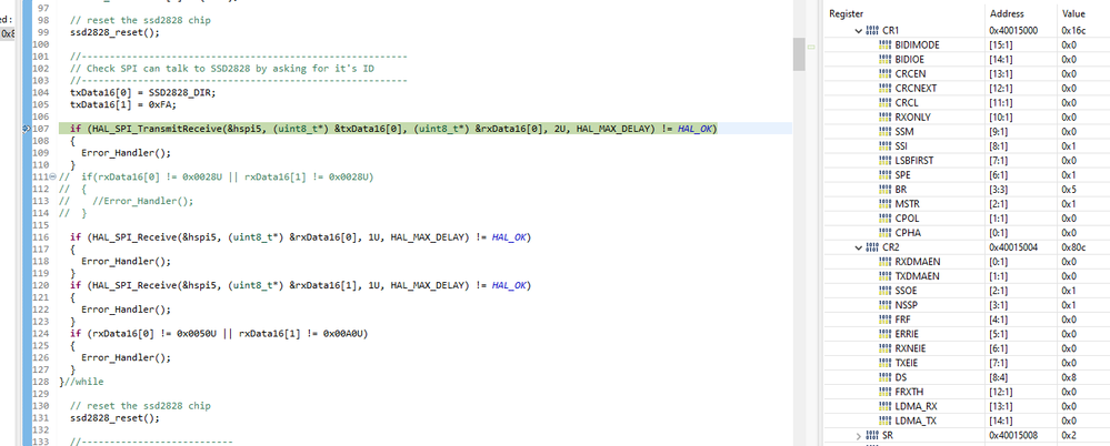

SPI registers:
First HAL_SPI_Receive
Second HAL_SPI_Receive

2021-07-09 12:47 PM
OK but the SPI received exactly what you've shown... The SPI module has no way of knowing that the slave is transmitting 8 bits - you've set it to 9 bits. Tx and Rx in SPI can't be decoupled, it happens along the same number of clocks.
I don't know what is the slave chip you are talking about, but it's highly unusual that a SPI slave would expect to receive a different number of bits within one frame than it transmits. If this is indeed the case here, you have to take this into account and "manually" merge the 9-but received frames and then split them to 8-bit pieces.
