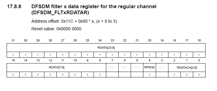

2020-05-12 10:54 PM
may be the data register of the DFSDM filter should be the Source address :
