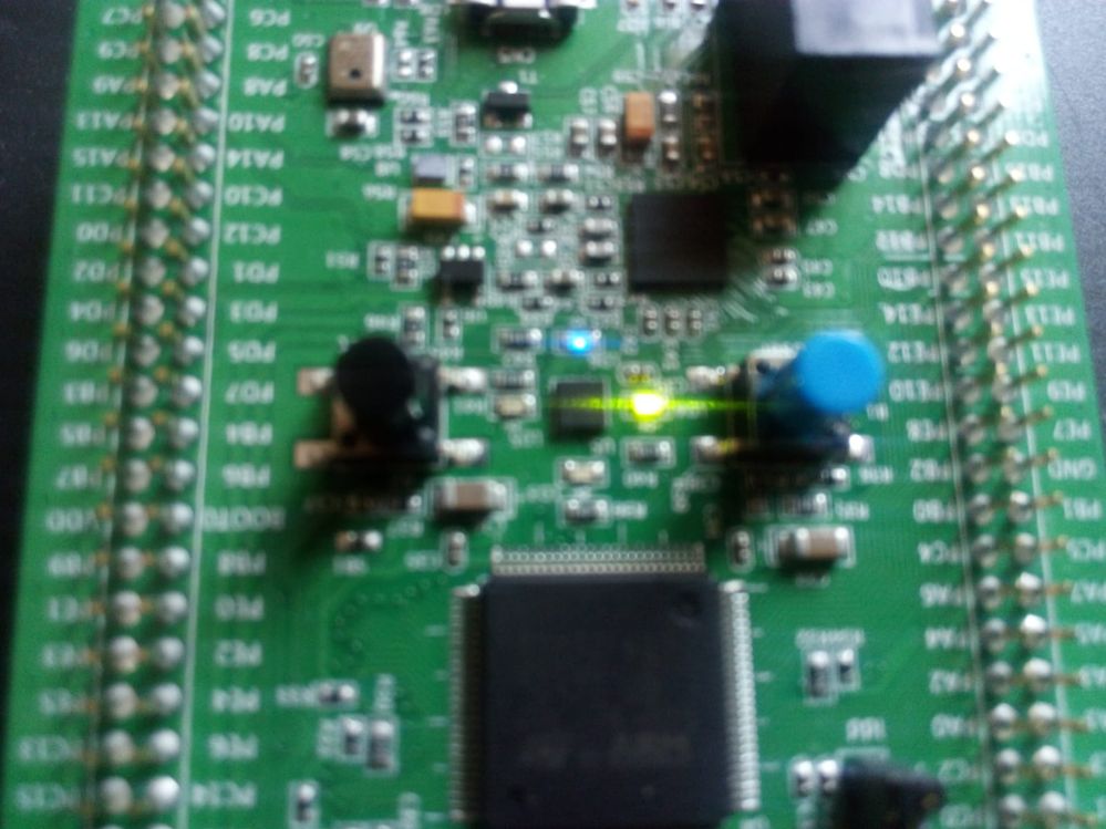

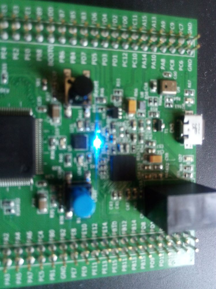

sorry, i think i couldn't explain problem clearly. With this code, here is the result.
And if ichange GPIO_PIN_12 to GPIO_PIN_15 (in line 9 and 11) i see that

The problem with the implementation is that the local/auto variables are allocated from the stack, and don't have explicit initialization. The result is that the structure can contain random junk and this subsequently gets injected into the peripheral configuration registers, undefined/unexpected behaviour can then occur.
By clearing the structure the behaviour becomes significantly more predictable. Generally it is advisable to initialize all fields in a structure that down stream code might depend upon.
