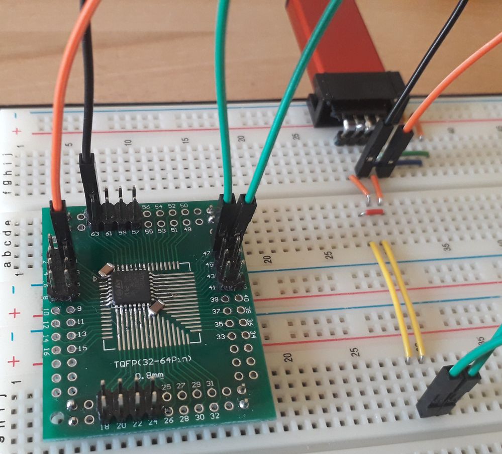

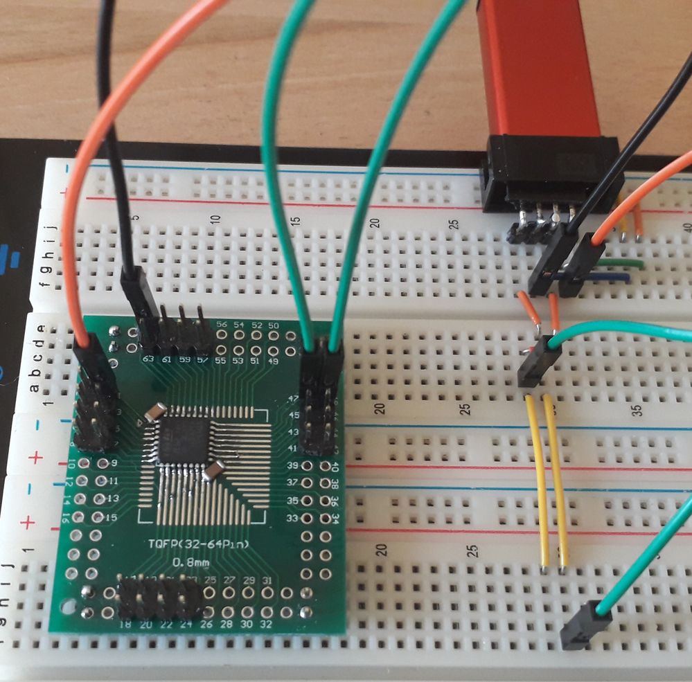

Check the continuity

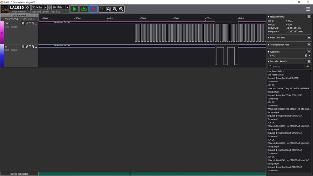

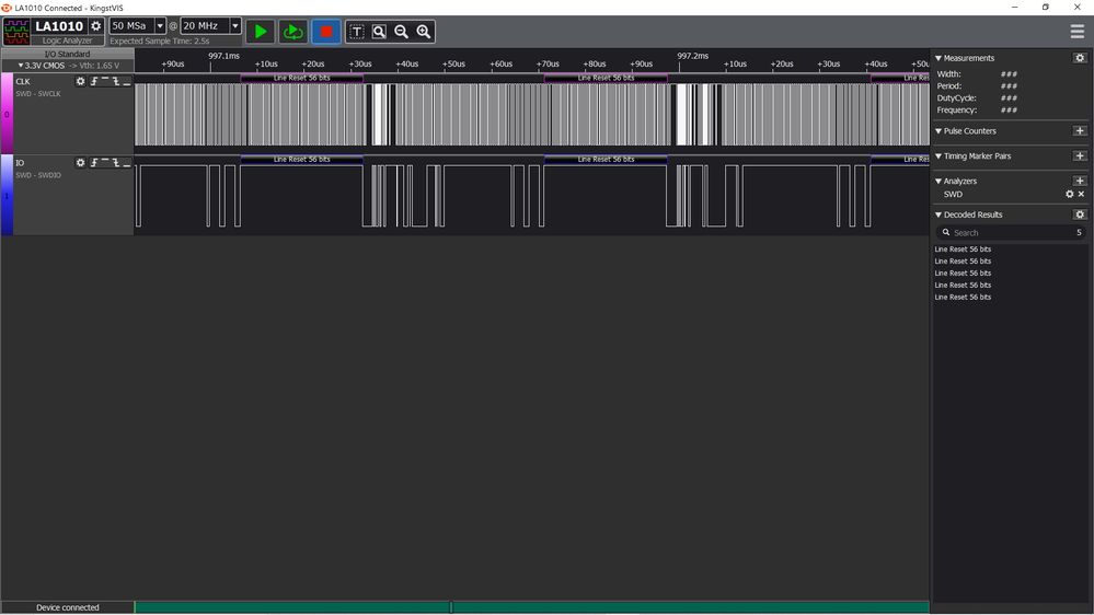

Check signal with scope

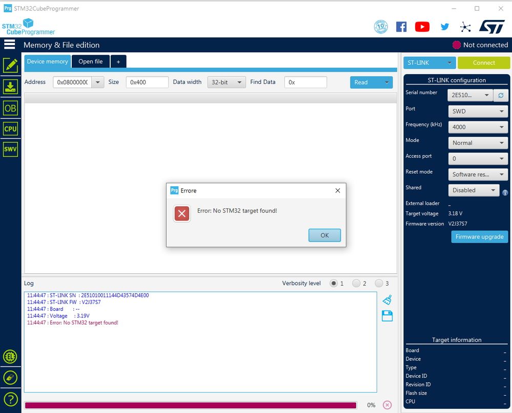

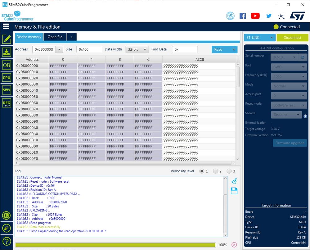

Your STLink works. I have similar issue, on my L073 the StLink couldn't t connect. It was connecting and suddenly ST link interface stopped to work - on good few chips. St link was able to downlod the code in USART mode.
For me it is an issue with the chip - it is very sensitive.
Try following:

The CM0 parts want slower clocks on the SWD

... Check the continuity
It's ok.
... Check signal with scope
It seems that the MC is not responding in the second position of the breadboard.
first:second:

... Ensure you StLink works on some other device.
I tried another StLink, same behavior.
... Connect the uC via USART in boot mode.
I will try
