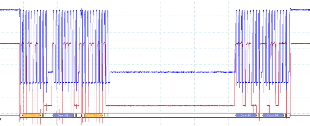

A good transaction looks like:
this is a register read (addr-len=1) for a two-byte response.

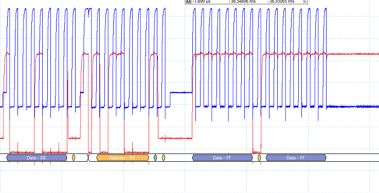

my bus error transaction (some bus, devices, etc):
My software detects the bus error and stops in sw breakpoint (after returning from ISR).
I see different strange characteristics in this picture:
1) the clock stretch of the PSU is shorter than the good TA.
2) the returned register content of the PSU is 0xffff; this is suspicious on the protocol level, as this is a strange slinear16 value.
3) there is no second master ack after the last byte and no end marker. Both ack=1 and end-marker would be a function of the master STM, or am I mistake?
My only reponse to this incident is to drop the data and reinitialize the stm32-hal-i2c (deinit/init). But I suspect this event to also inpact the stability of my code, as I do get sporadic hard-faults when I run this software without debugger support.
Any explanations/ideas/proposals for improovements?
Thanks a lot,
Bernward

Yes I agree that observation 1+2 look like a problem of the device.
Still, a short clock stretch and a high sitting data-line are to my understanding a valid bus state (from device pov), and I'm missing the ACK /end marker of the STM32H743 core. So I'm looking for an explanation, why this is a bus fault from STM master pov.
Thanks a lot,
Bernward

YES, I'm using stm32h7xx_hal_i2c.c as of december 2021. And no, you can't debug that, because that behaviour is probably part of the ASIC implementation of the STM32H743 i2c core. So I do not see that the stm 32 hal is sending a ack/nack by command.
My question is, if this recorded trace with all stm code can be explained to be i2c standard conform. I see it conflicting to my understanding of I2C signalling.
Thank you.
