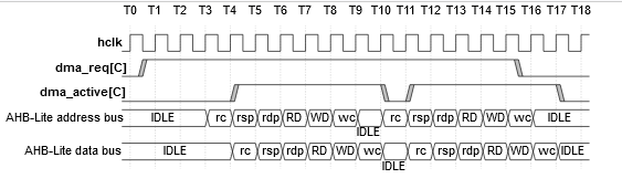

It works something like described in this article under DMA Level request:

The STM32 does not use the DMA unit ("cell") described in article you linked into.
