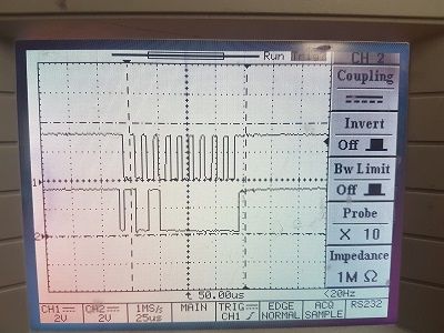

Thank you for your response. Yes. I hooked SDA/SCL up to a scope and checked out the signals. The rise looked a bit woolly, so I reduced the pull-ups to 1K.
Above shows the trace when running the IsDeviceReady() on 0xA0 (the CAT24C512).
However, if I try to write to the device afterwards, It still fails to write. Then the mem device appears to lock up - that is I get a not ready response if I try another IsDeviceReady().
Not quite sure where to go with this at the moment. I have an I2C bus analyser on the way, maybe that will shed more light - but I've never had to use one in the 10years of my using I2C on other controllers.

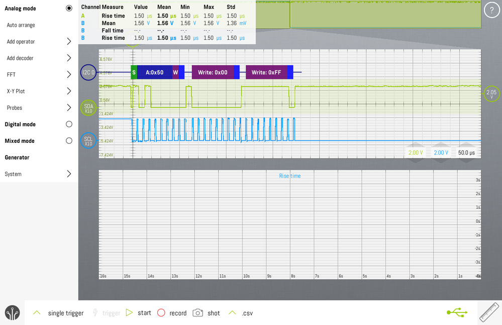

My scope was purchased sometime ago and the application that came with it does not work with windows 10 unfortunately. However, I have just received my smartscope and have captured the following:-
Comparing against the i2c spec, the start condition is correct as are the 'ack's. The slave address and the internal address to write to (0x00FF) are also correct.
The interesting thing to note from the trace above is that everything seems to be going swimmingly until its time to write the data - then the clock stops (SCL stays low).
I do, in the depth of my bits box somewhere, have a disco476, so will dig it out over the weekend. I don't believe it has an I2C memory device on it though.
