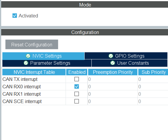

I have copy->paste the library into my STM32 and it works great to read the SAE J1939 signals from the ECU unit. But when I'm going to write to the ECU unit, then nothing happens. It's not the librarys fault. It's the CAN-bus settings in STM32CubeIDE.
This is how I have done:

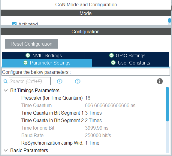

Step 1: I KNOW that the ECU has 250 kb/s baudrate. So I tune that in inside STM32CubeIDE
Step 2: Then I create my CAN-bus layer code. It's for STM32F3 if you wonder.

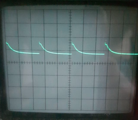

SAE_J1939_Send_Request_Address_Claimed(&j1939, 0x80);I hook up an oscilloscope and analysing the signals.
Settings:
1V divider
20 uS sweep time

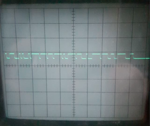

CAN+ from my STM32 board:
This is a request ID for Address Claimed = 0x00EE00
ID = 0x18EA8022 = 0b00011000 11101010 10000000 00100010
DLC = 3 bytes
DATA = 0x00EE00 = 0b00000000 11101110 00000000

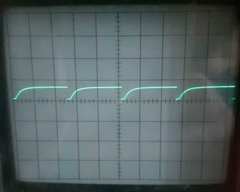

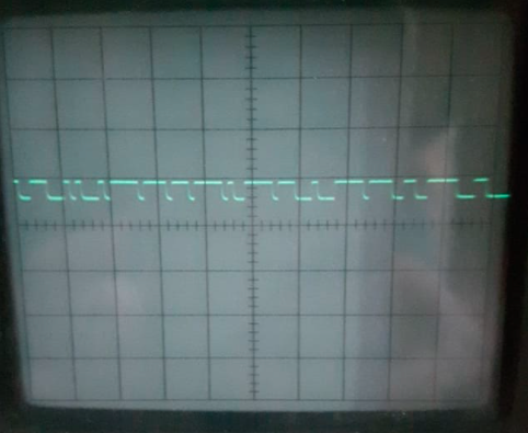

CAN+ from the ECU:
Question:
Judging by the CAN+ signals, how different they are. Can it be that I have seleted wrong baudrate?
Why can I read the signals from the ECU, but not write to the ECU?

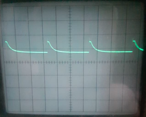

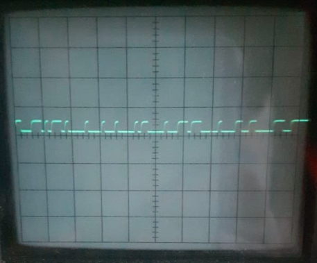

Edit:
Here is more pictures. The same settings as above.
CAN+ and CAN- from ECU
CAN+ and CAN- from STM32F3:
2021-07-21 9:45 AM
Is the STM32 flagging any error/status?
The CAN+/- look Ok
Have you tried a pair of STM32 talking to each other, or CAN1 to CAN2 out-n-back test?

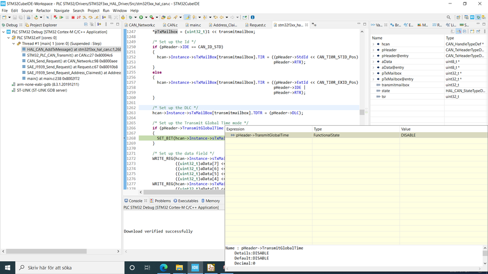

By the way! I notice something weir.d
This code runs, even if TransmitGlobalTime is DISABLE
/* Set up the Transmit Global Time mode */
if (pHeader->TransmitGlobalTime == ENABLE)
SET_BIT(hcan->Instance->sTxMailBox[transmitmailbox].TDTR, CAN_TDT0R_TGT);
}Have a look

Is there any way I can put CAN- constant low and CAN+ constant high in STM32CubeIDE?
I want to measure the voltage between CAN+ and CAN-. Perhaps the voltage is to low?
