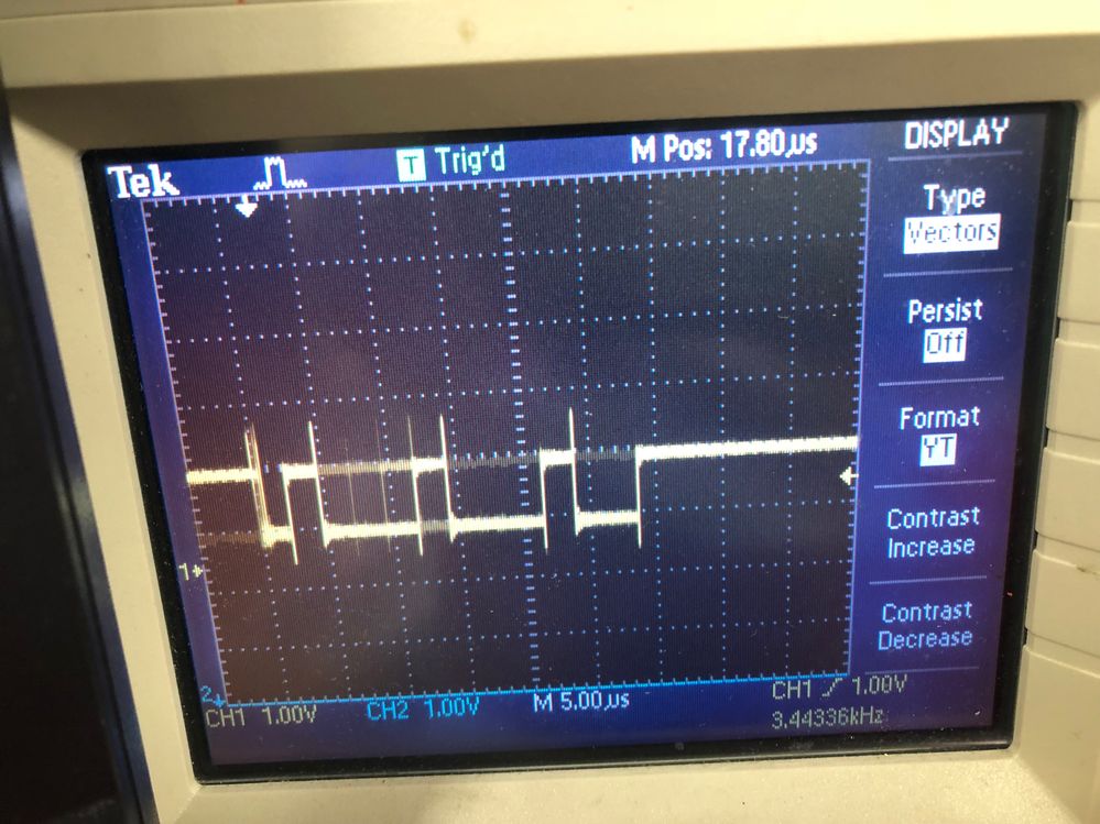

Synchronous. Clocks are currently generated from our FPGA, passed through a couple video driver ICs and load resistors mostly just to condition the pulse amplitude to what the CCD needs. Using a 20MHz crystal for master. See below for an example of the output signal I need to send to the controller box. High is 0, low is 1, each bit is roughly 2.2us width, the final 0 and 1 are the stop bits and are added after ADC conversion in our FPGA before it spits out the signal. This image is the final conditioned signal after a transistor and a couple resistors.

I'm not worried about the bit count. So in the picture above, our controller would read these bits right to left as they are streamed in. The final two bits (a 0 followed by a 1) are not part of the data count but are added by our FPGA as part of the signal to the controller to stop reading. Is the STM32 capable of adding bits in it's logical output? I'm unfamiliar with microcontrollers as a whole and was wondering if this capability exists.
