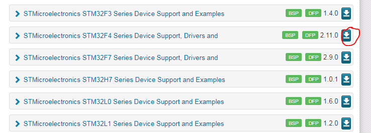

I have downloaded STM32cube, and went to demonstration and wanted to build the project but it says:
The following Device Family Pack(s) are required by the project:Keil:STM32F4xx_DFP:2.11.0And when I push install button below the message it says: ' one or more Device Family Pack Device are not present, would you like to choose another device?'

Hi
hamintouri1
,Could you please try to download directly theMDK5 Software Pack (
STM32F4xx_DFP:2.0)
from thishttps://www.keil.com/dd2/pack/
-Nesrine-
2017-09-08 4:05 AM
Thank you Nesrine,
But I chose to select another device and I did select 'stm32f407vgtx' from 'software packs'. and problem solved and I built the project and ran it OK.So, did I do a wrong way? Should I download the package you put? what is that?
