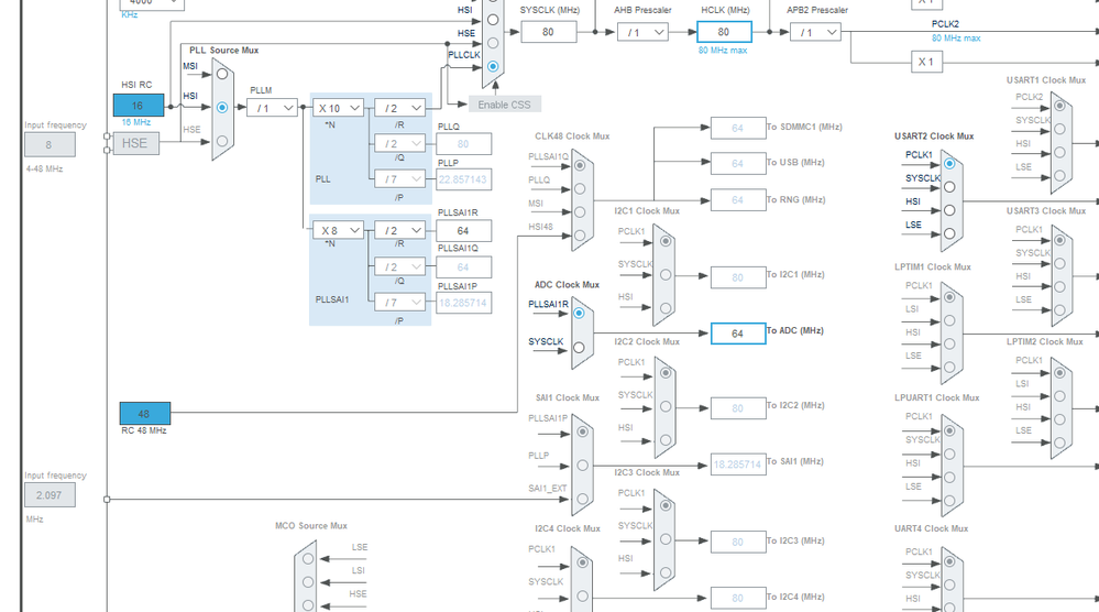

I am using a Nulceo-L452, down below the whole code, but first some high lights:
//To convert I read VDDA and used the macro:
temp_celcius = __HAL_ADC_CALC_TEMPERATURE(3285, adc_in17, ADC_RESOLUTION_12B);
// I set enough sampling time
sConfig.SamplingTime = ADC_SAMPLETIME_640CYCLES_5;
ADC Clock 64Mhz

2023-01-10 2:15 PM
I improve accuracy using:
HAL_ADCEx_Calibration_Start(&hadc1, ADC_SINGLE_ENDED);
