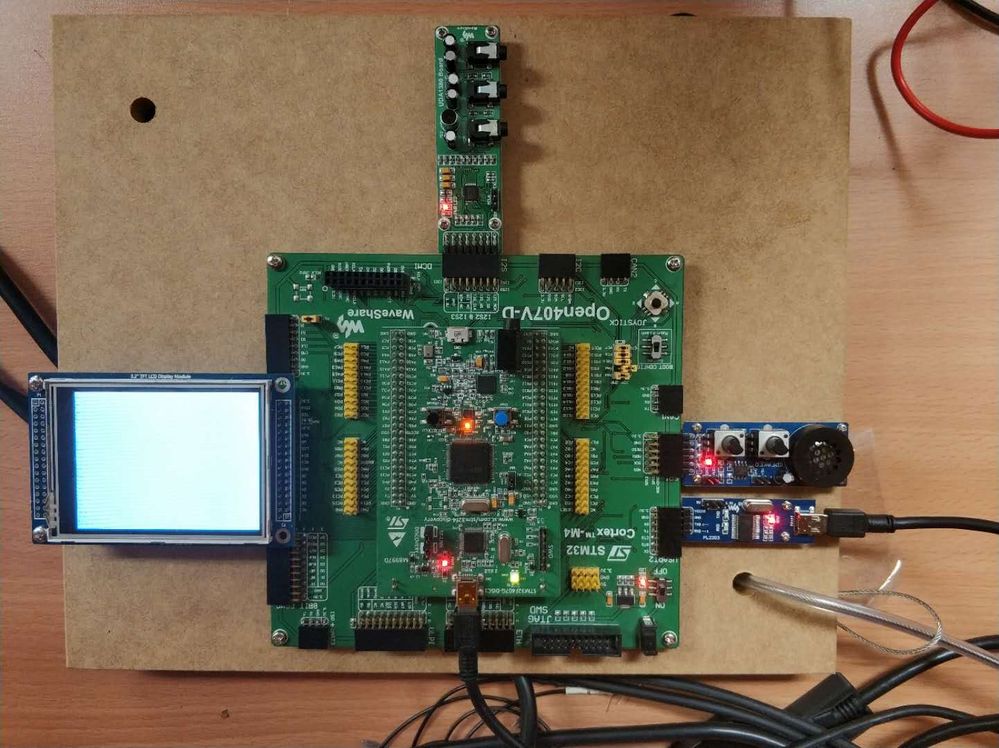

The question including in the 1st picture i want to ask that is that any material allow me to learn for coding and solve assignment question.2nd picture whole part of board

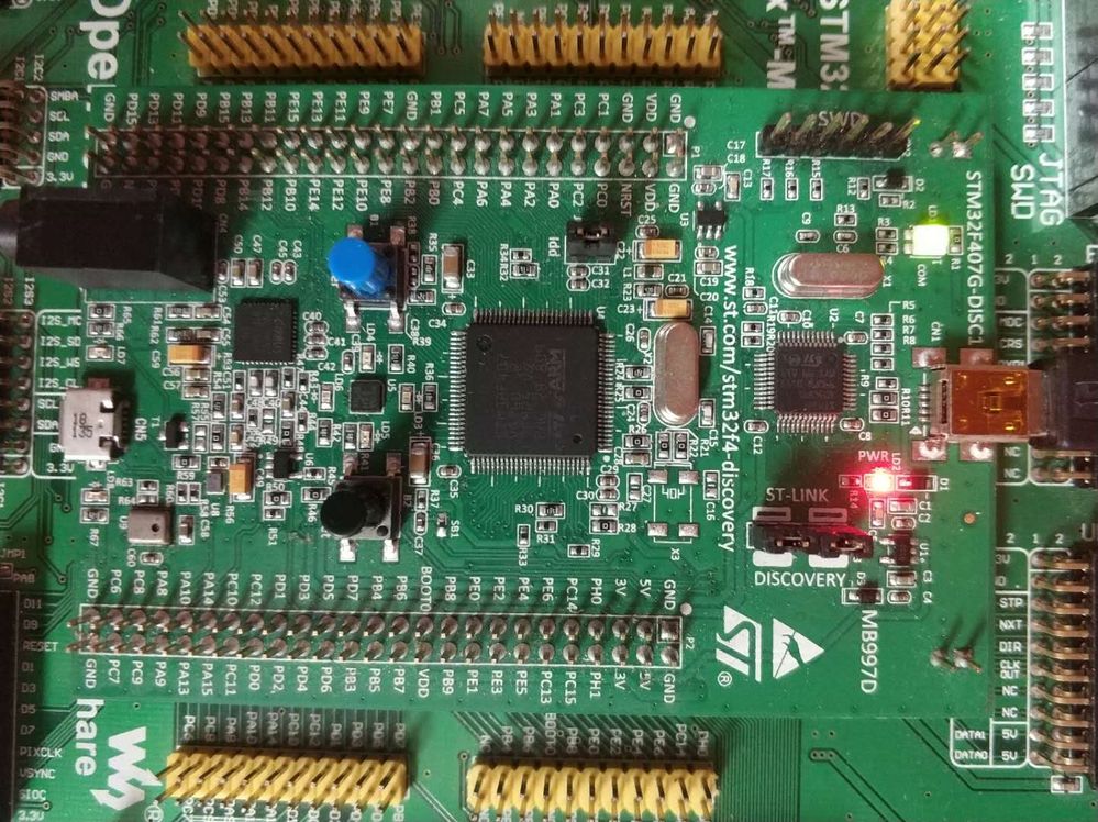

3rd picture is STM32F407

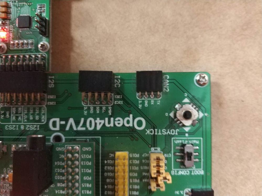

4th picture is the part of the joystick
