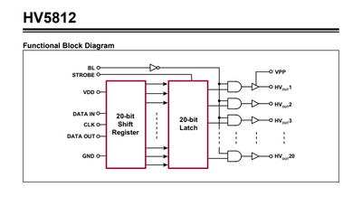

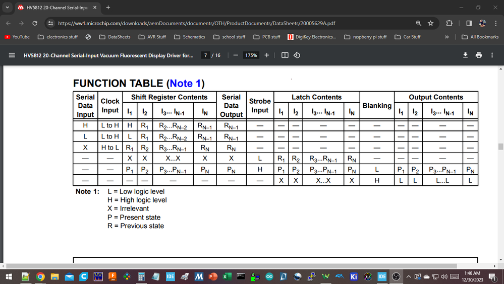

could someone explain how this chip works this function table is so confusing to me

...seems not difficult, you have to make connections to: (+vpp , vdd, gnd )
- data in
- clk
- strobe
- blanking
-> blanking : hi = display off ; lo = display on.
-> clk : on lo->hi transition data is shifted in;
-> strobe : lo->hi transition data is stored in latch; lo->hi->lo to store data .
So full sequence to show a pattern is:
( set data in hi or lo , switch clk lo->hi->lo ; ) 20 x , for 20 bits /segments ;
set strobe lo->hi->lo ; = data is on outputs (+ blanking always lo, if you dont want switch off the display)

So just Like the 74hc595 ok
