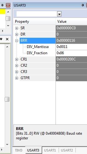

2019-04-08 9:45 PM
USART3 register when 32MHz

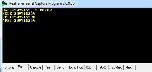

2019-04-09 12:03 AM
Core=2097152, 2 MHz
HCLK=2097152
APB1=2097152
APB2=2097152
