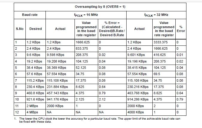

Please correct my configuration ?
void MX_USART3_UART_Init(void)
huart3.Instance = USART3;
huart3.Instance->BRR=34;
huart3.Init.BaudRate = 115200;

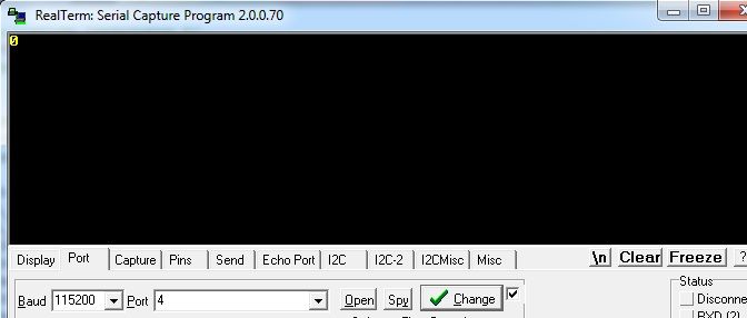

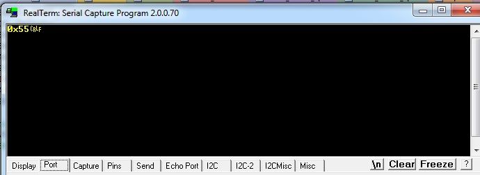

2019-04-08 1:34 AM
baudrate 115200 clock = 2.097Mhz
Send 0x55, code
printf("0x55");
printf("\r\n");
output :
clock = 32Mhz,
baudrate = 115200
output :
any clues ? thanks

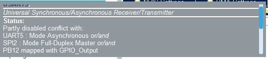

On STM32CubeMX, it said, UART3 has a conflict, does it matter ?

Sometime it's easier to check on the datasheet alternate function table.
Anyway only one alternate "output" can be activated (it's a mux) at anytime.
Do check the GPIO registers in debug mode HW register view.
Check on GPIO MODER and AF registers for this pin.
