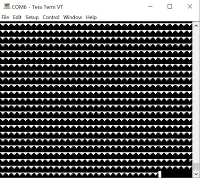

But, HSE 8Mhz crystal, broken uart message.
Only difference function "void SystemClock_Config(void)"
How can i fix it?

Terminal message [broken]

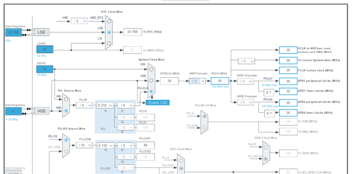

this is my SystemClock_Config source
// Configure the main internal regulator output voltage
__HAL_RCC_PWR_CLK_ENABLE();
__HAL_PWR_VOLTAGESCALING_CONFIG(PWR_REGULATOR_VOLTAGE_SCALE1);
// Initializes the RCC Oscillators according to the specified parameters
// in the RCC_OscInitTypeDef structure.
RCC_OscInitStruct.OscillatorType = RCC_OSCILLATORTYPE_HSE|RCC_OSCILLATORTYPE_LSE;
RCC_OscInitStruct.LSEState = RCC_LSE_ON;
RCC_OscInitStruct.PLL.PLLM = 8;
RCC_OscInitStruct.PLL.PLLN = 216;
RCC_OscInitStruct.PLL.PLLP = RCC_PLLP_DIV6;
RCC_OscInitStruct.PLL.PLLQ = 2;
RCC_OscInitStruct.PLL.PLLR = 2;
Error_Handler();
// Initializes the CPU, AHB and APB buses clocks
RCC_ClkInitStruct.APB2CLKDivider = RCC_HCLK_DIV1;
if (HAL_RCC_ClockConfig(&RCC_ClkInitStruct, FLASH_LATENCY_0) != HAL_OK)
Error_Handler();

Sorry, but what STM32 part are you talking about and on what board?
Check HSE_VALUE is reflective of the actual HSE Frequency.
2023-12-14 4:13 AM
Hello.
I also checked that HSE_VALUE is correct.
#define HSE_VALUE ((uint32_t)8000000) /*!< Default value of the External oscillator in Hz */
Part name is "STM32F412RGT6"

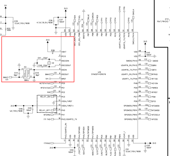

Include board schematic.
We are modifying and testing the circuit for the CTS RTS test of UART1.
UART6 is used as CTS RTS, and UART3 is used as USB output debugger.

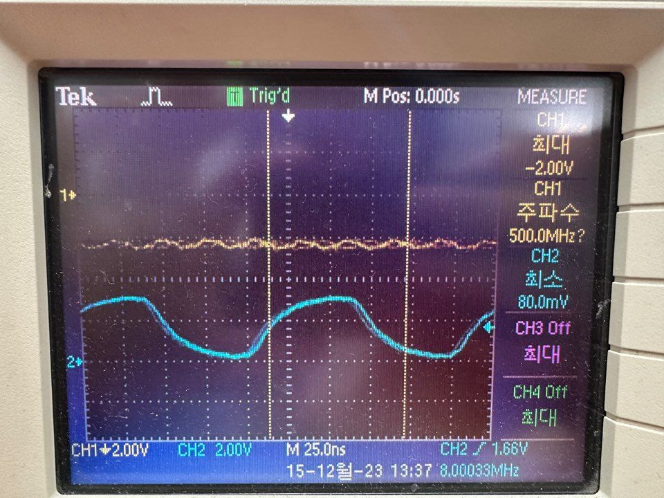

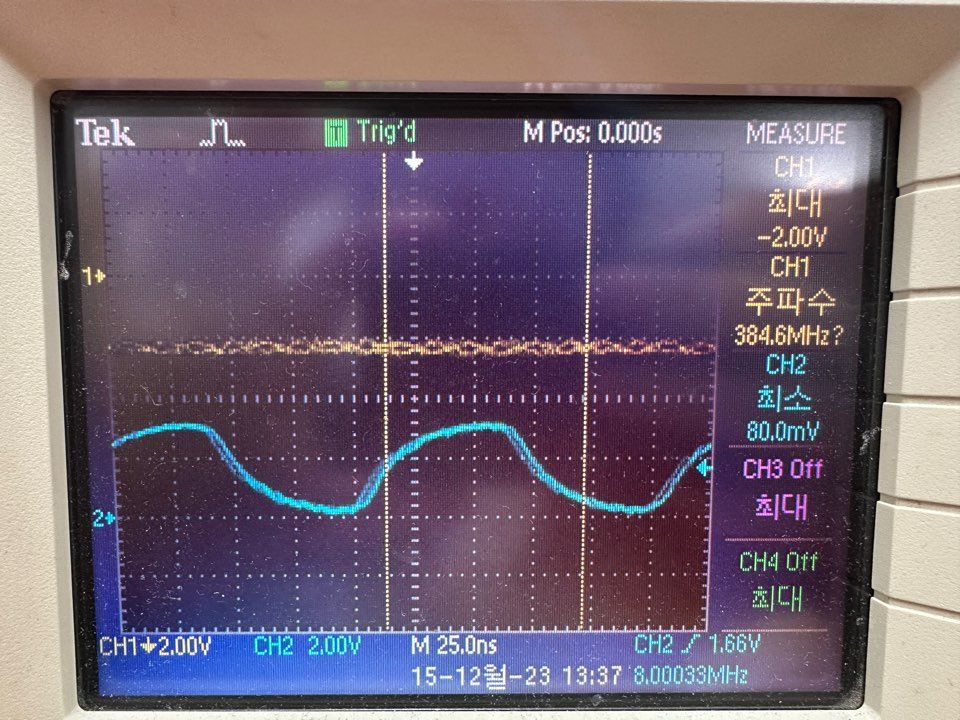

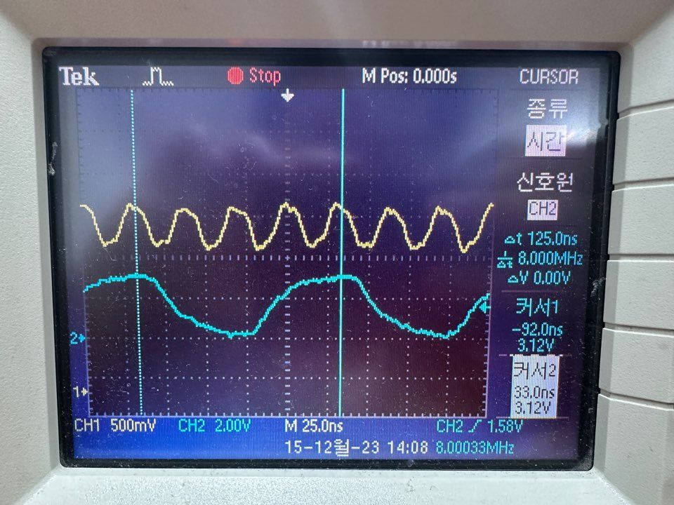

First try to output your system clock on MCO pin and check if you get your 36MHz. It could be something not good from your external crystal/resonator.

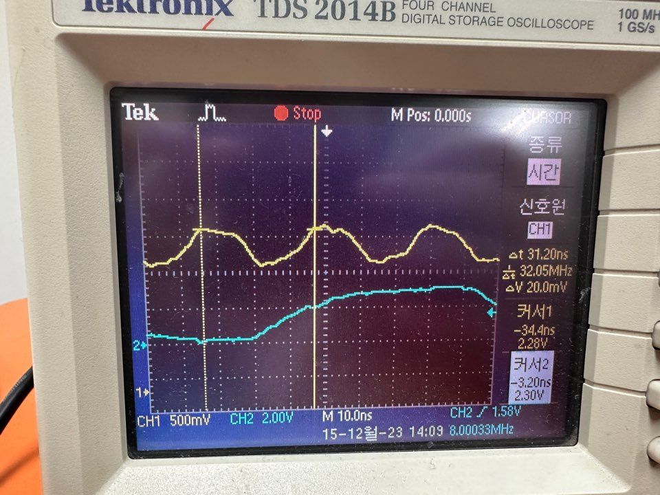

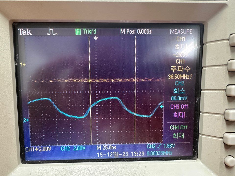

2023-12-14 8:29 PM
Like you said
I measured the following using an oscilloscope.
When in HSE mode, the frequency is abnormal as shown below.
[When in HSE mode = Abnormal (Fail)]
PA8(HSE), PC9 (SystemClock)
CH1 = System clock = PC9(System Clock)
CH2 = Crystal Clock = PA8(HSE) is 8Mhz
[When in HSI mode = Normal (Pass)]
CH1 = System clock = PC9(System Clock) is 15.96Mhz
CH2 = Crystal Clock = PA8(HSI) is 15.96Mhz
Below are photos and measured videos.

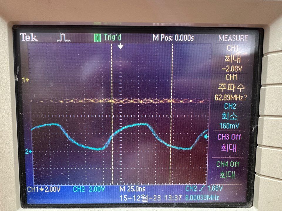

2023-12-14 8:58 PM
We don't care what Mhz the system clock is set to.
So I changed the settings as below.
HSE 8Mhz
System Clock 32Mhz
I confirmed with an oscilloscope that 32MHz was coming out.
The same broken phenomenon still occurs in UART.

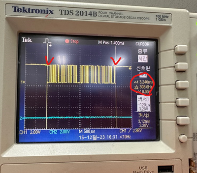

2023-12-15 1:26 AM

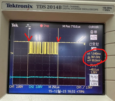

I will organize and upload the (.Ioc) file attachment.
Although I am using FreeRTOS,
Test USART1 with an oscilloscope
I sent a sample message with Uart.
“Hello world!”
Just swap HSI and HSE.
HSI = 1.040ms / normally received
HSE = 3.240ms / Data corruption phenomenon
The difference between HSE and HSI is 3.11 times.
[Hello world! , HSE = 3.240ms]
[Hello world! , HSI = 3.240ms]
