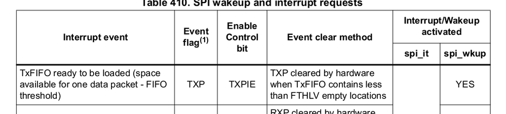

I'm trying to debug a problem by which, if the EOT IRQ is enabled, an SPI slave enters an endless loop of ISR executions. I suspect it might be related with how IRQs are generated.
According to the H7 user manual:
The TXP interrupt is generated whenever there is space available in the TxFIFO. Does this mean that the above IRQ will fire endlessly if the Tx FIFO is never filled? In other words, if the above IRQ fires but the corresponding ISR doesn't even write to the TxFIFO, will it fire again immediately after the current ISR returns?
Also, is there any problem in enabling interrupts before filling the TxFIFO?

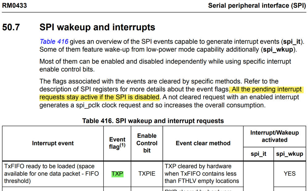

Hello @DGast.1,
Yes, if the TXP interrupt is enabled (ready) and the Tx FIFO is not being filled by the corresponding ISR, the interrupt will continue to fire indefinitely as long as there is space available and not used in the Tx FIFO. Also, enabling interrupts before filling the TxFIFO should not cause any problems as long as the interrupt priorities and ISR handling are properly configured.
As mentioned in the description, all the pending interrupt requests stay active if the SPI is disabled.
Hope it helps.

2023-12-15 6:33 AM - edited 2023-12-15 6:35 AM
Hi again,
I have run another experiment, this time with the driver in Zephyr RTOS for H7's SPI. I have printed the SR register in the interrupt handler and had verified that the only flag that is enabled in several of the cases is TXP. This leads to the conclusion of that such IRQ needs to have been triggered by TXP, as that's the only enabled bit. This contradicts my previous experiment though, however this seems more reliable as it's a much simpler experiment.
Note: bear in mind that this experiment doesn't set the FIFO threshold at all, so it remains at threshold = 1. My previous experiment did set the FIFO threshold, so maybe the difference in results is caused by that.
