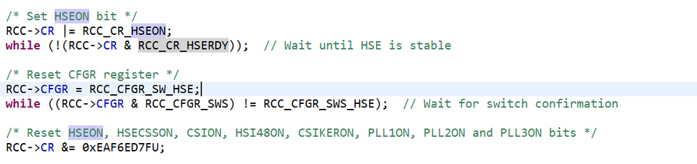

LED, SPI are working with external clock. There is only issue with CAN.
HSE is ON in the driver generated even then I am getting issue in transmission. I am able to transmit but unable to get on BUS.

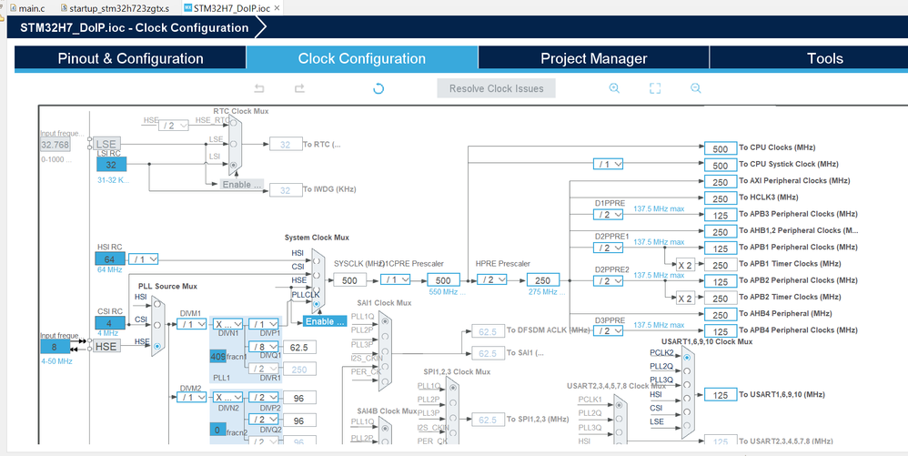

Thank you for sharing the ioc file,
But according to ioc file attached:

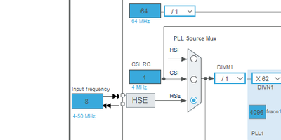

1- The HSE value is set to 8MHz contrarily to what you said
@Aashritha_Vuda wrote:
I am using crystal oscillator with 12MHz frequency,
Need also to clarify what do you mean exactly by "Crystal oscillator"? a crystal or crystal oscillator? see this article.

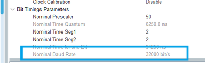

2- The FDCAN configuration you set is at 32kb/s:
Which is not inline with what you said in the first post:
baudrate 500k, clock frequency to CAN is 8MHz and all
Could you please double check and confirm?

I used a crystal. The frequency of that crystal is 12MHz. Baud rate is set to 500k by changing nominal prescaler, timsegment 1 and 2.
