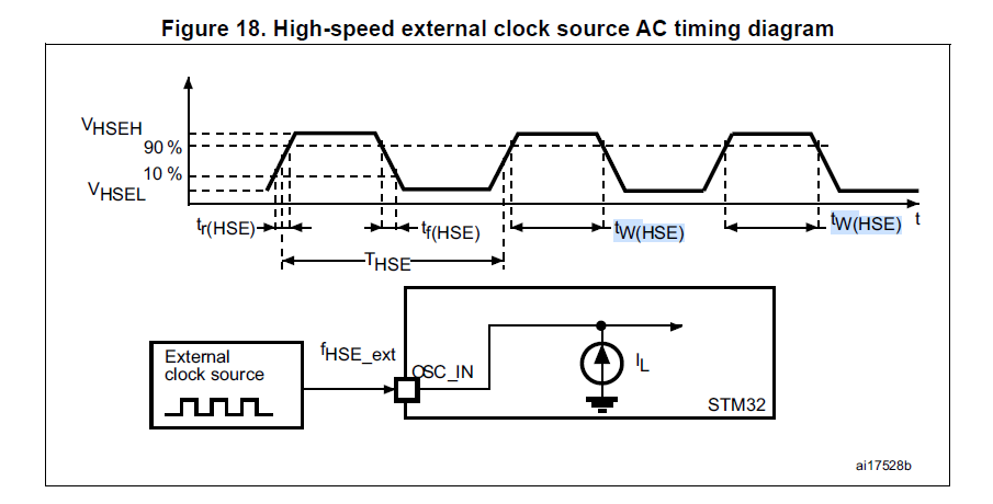

Hello @NiM ;
First of all, I apologize for my late reply.
The design is not sensitive to these parameters (tr and tf).

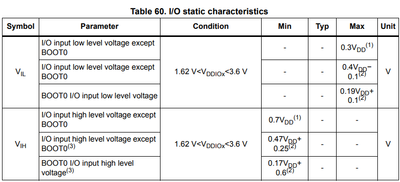

In bypass mode the signal goes through a GPIO input. So for STM32H7 the constrains are the same as for a GPIO input.
You should respect the VIL and VIH threshold provided in table "Table 60. I/O static characteristics"
I hope this answer your request.

2025-09-01 7:28 AM
THSE is just the period of the signal; ie, 1/fHSE_ext
2025-09-01 7:31 AM - edited 2025-09-01 9:28 AM
@KDJEM.1 wrote:The design is not sensitive to these parameters.
So why does the datasheet call them out like this?
I think the datasheet needs an update to either remove them, or to say that they're unimportant.
