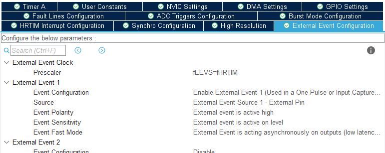

I've configured external event 1 with level sensing and asynchronous action in CubeMX, but I continue getting high response time latency (>7 cycles of fHRTIM) and a response time jitter of 1 cycle of fHRTIM clock (5.8ns), instead of the minimum jitter I would expect. Also, pulse width has no jitter, as expected when FastMode is disabled.

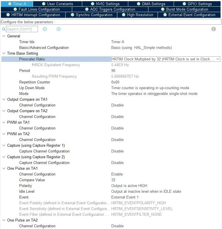

CubeMX settings are as follows:

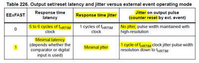

For "time jitter" I actually mean the "Response time jitter" (as in Table 226, pag. 877 of RM0440 Rev 8):
According to this table, the Response time jitter should be "minimal" in Fast mode (EExFAST=1). Instead I get a Response time jitter of 1 cycle of fHRTIM clock (5.8ns). It seems that FastMode is not being effective at all. I don't understand if CubeMX is not setting it properly...

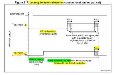

I would need to produce a pulse with minimal latency and no jitter as the one in the lower portion of Figure 217 (EExFAST=1), instead I get a pulse as EExFAST was 0:
