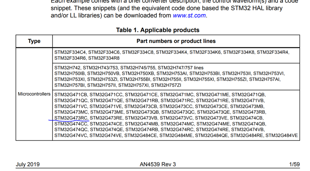

Hello all, regarding Application note AN4539 all MCU's of STM32G4 shall support HRTIM peripheral, reference manual also describe HRTIM functionalities for all STM32G4, but on some pages and datasheet it is no information about HRTIM support.
Which information is correct then?
P.S. For example STM32G473RC shall support HRTIM, but it is not mentioned in datasheet

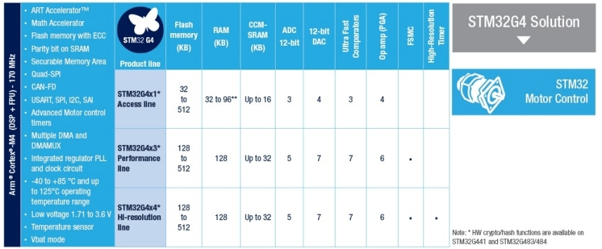

If you go to this web page, at the bottom you will find a table that summarizes the main differences between the various devices of the STM32G4 series:
From it you will see that all devices that end with "G4x4 *" have the HRTIM.
Therefore if I download the data sheet of STM32G474RE (for example) on the 1st page HRTIM will also be listed among the various timers available.
The "G4x3*" series does not have the HRTIM, So the STM32G473RC you highlighted doesn't have HRTIM.
Best regards
Andrea

Yes, it's definitely a mistake. Also because it doesn't seem to me that the STM32F3 has the HRTIM (as instead appears in that table).
Regards
Andrea
