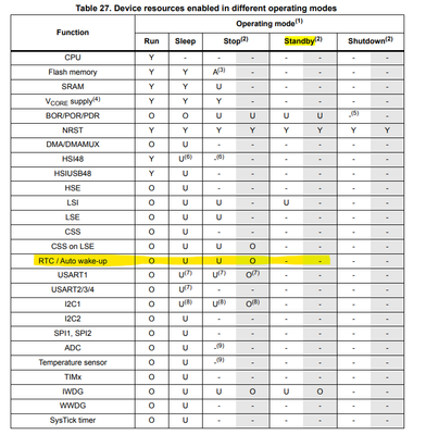

On a STM32C0, RTC cannot wakeup from standby mode, see ref.man Table 19. "Device resources enabled in different operating modes"
But, for short intervals like 30s, you may use the IWDG for that.
hth

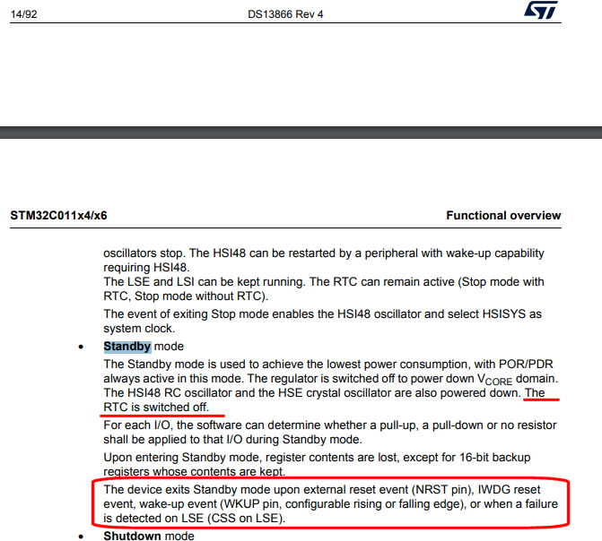

The Data Sheet and/or Reference Manual will list all the available ways to exit the various low-power modes - so look there to see what RTC feature(s) are available to wake-up...
An Alarm, perhaps ... ?
PS:
Datasheet says RTC is turned off in Standby Mode - so not a wakeup option:
So your options are:
hth
KnarfB

Hello @DavidL_,
As already said by everyone, always check this table in your product RM:
"-" = resource not available / without wake-up capability (grayed-out columns)

@DavidL_ wrote:I was looking in the datasheet which was the wrong place :)
As shown, the information is also in the datasheet!
