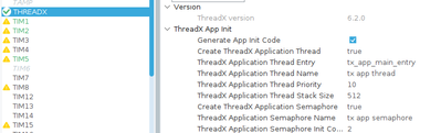

you can use the first and only thread, that is generated by Cube if you let it do it :
then in core -> app_threadx.c :
i just rename this first thread to >> tx_app_main_entry << , to see my "main" now by a similar name. :)
so write here, what you in old times wrote in "main" , here my H563 program begins:

let Cube make a first thread for you , as i wrote . then write there, what you would/want write as your "main".
