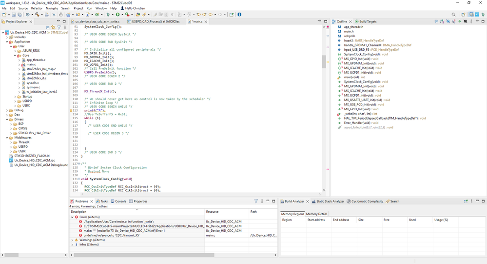

2023-11-20 6:48 AM - edited 2023-11-20 6:53 AM
to use printf(...) you need to send it to the usb->cdc ;
put in main:
int _write(int file, char *ptr, int len)
if(CDC_Transmit_FS((uint8_t *)ptr, len))
HAL_Delay(2);
CDC_Transmit_FS((uint8_t *)ptr, len);
return len;
just a quick and dirty test...try :)

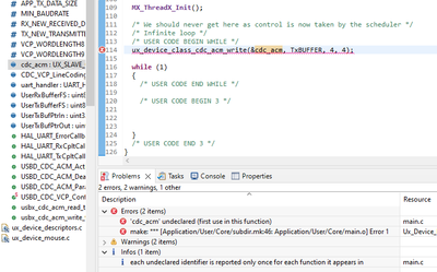

I try to use the Function "ux_device_class_cdc_acm_write" in main.
I got an error that cdc_acm is undeclared.
Were I can find the adress or where I get the adress?

2023-11-21 2:05 AM
look at examples , like this:
https://github.com/Dbotelho2000/CDC_USBX_G474/blob/main/USBX/App/ux_device_cdc_acm.c
https://github.com/search?q=usbx%20cdc&type=repositories

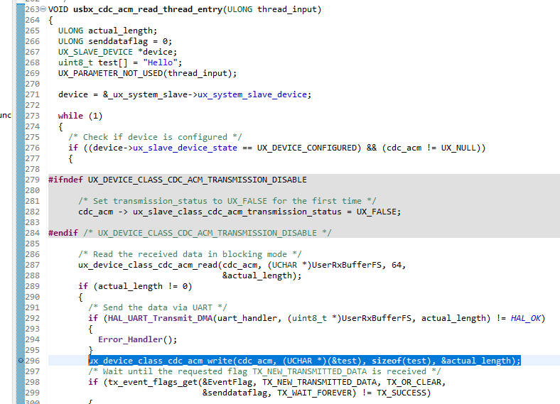

Thanks to @AScha.3, I found the function to send Data (ux_device_class_cdc_acm_write()).
But my fault was to call it in main.c
If I call it in ux_device_cdc_acm.c and it workin fine. Here my quick test:
I am happy to get this to work.
