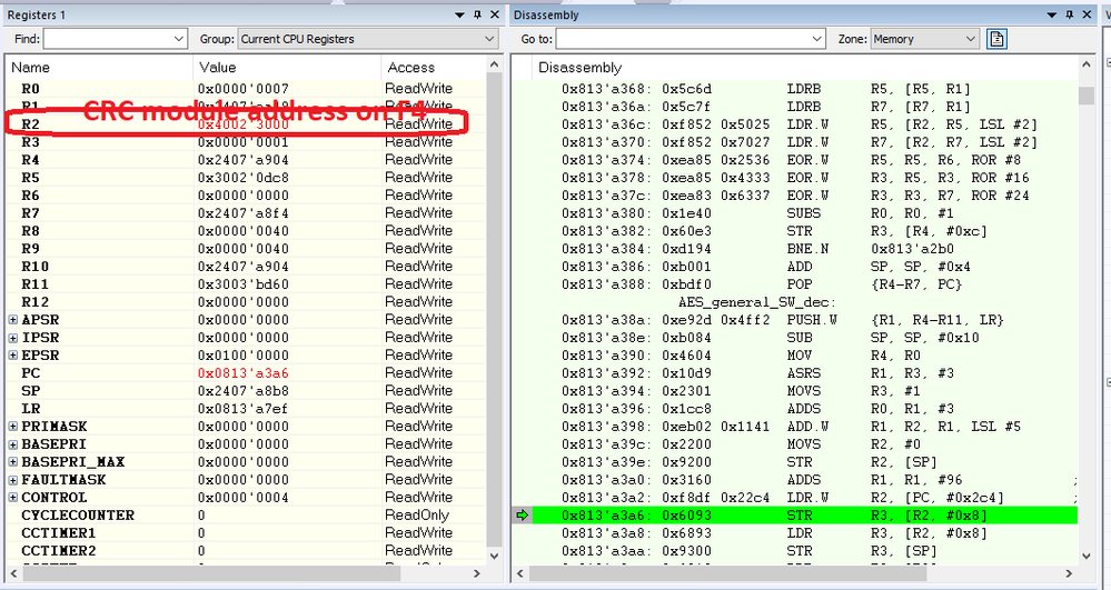

Hello @Jocelyn RICARD , @Community member
I reused the STM32CryptographicV3.1.1_CM4_IARv8_otnsc.a & STM32CryptographicV3.0.0_CM4_IAR_otnsc.a.on the M4-core of the H757 but as I explained it seems to use the CRC module. The CRC module boundary address is different between a STM32H7 and a STM32F4. .As you can see in the enclosed picture, the register R2 contains the address of the CRC module of the F4 MCU (0x40023000). After this instruction an hardware fault occurs because the code try to access to unknown address/register. The CRC module on STM32H7 is mapped at 0x58024C00. It's the address implemented in STM32CryptographicV3.1.1_STM32H7_IARv8_otnsc.a library. (see embedded picture)
