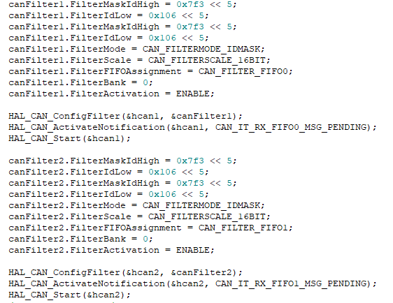

I will share the circuit diagram
2022-05-20 6:11 AM
The filter banks need to be split, there are 28 slots, the lower 14 typically to CAN1 and the upper 14 to CAN2, but you can select the mid/split point.
I've previously posted working examples of dual CAN for the RedDragon F407 board, but those admittedly used the SPL, rather than HAL, as the former was in active development then.
2022-05-20 6:13 AM
Masking/Compare doesn't strike me as getting ANY hits.
2022-05-20 7:45 AM
It is determined that the filterbank part is the problem.
There are filterbanks in can1 and can2 respectively.
Only the can that gives 0 to the filterbank value works normally.
I don't understand why..
